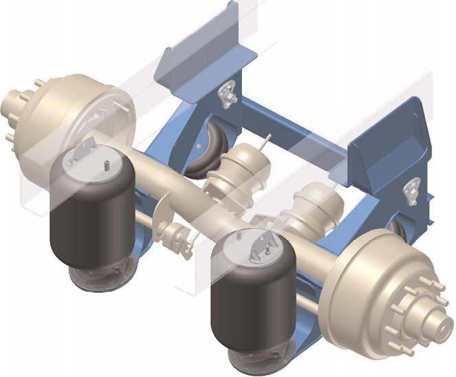

I have a question that puzzeled me, some of the Tags are in the front position of the tandem some are in the rear position WHAT GIVES???
Weight distribution, type of body, turn radius, wheelbase, etc...

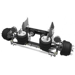

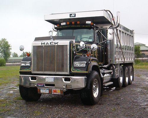

On a Dump Truck you don't want to tip that body up and have all of the weight transfer to a tag axle so the "Pusher Tag" is favored...quite common now for the axle to be a self steer style as well to reduce tire scrubbing when loaded.
I don't like the "Pusher Tag" style as they are in the way when trying to work under the truck and they can also fetch you up in deep snow or mud...also notice the first axle shown has a drop down in the center to clear the truck's drive line and is non steerable...
The second axle shown is a self steer model and has the axle low enough to pass under the drive shaft...

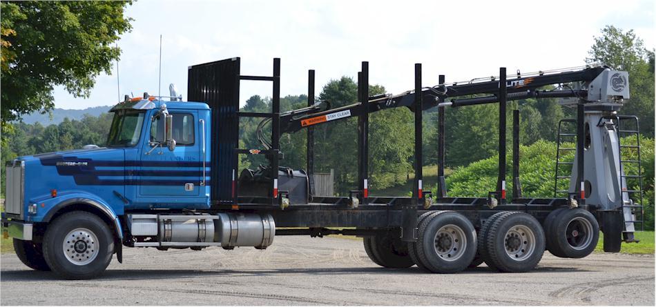

Longer wheelbase trucks will have the tag behind the drives, it can be lifted to ease tire scrubbing when loaded. Tags of either style add a complete extra axle worth of braking power as well...

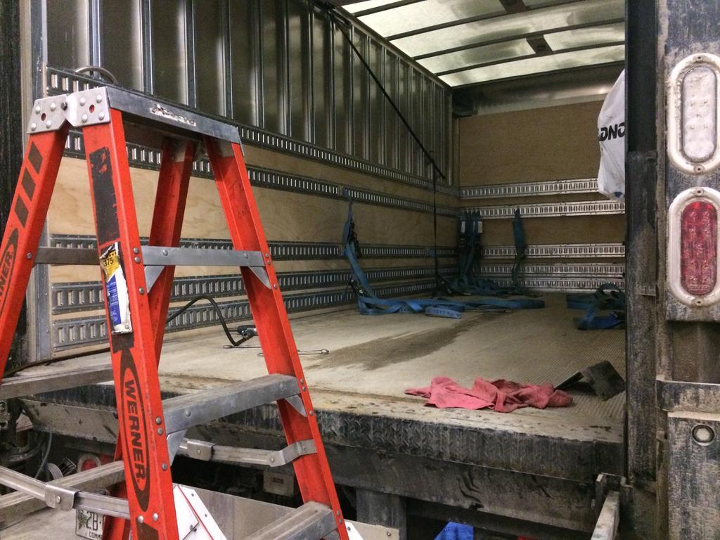

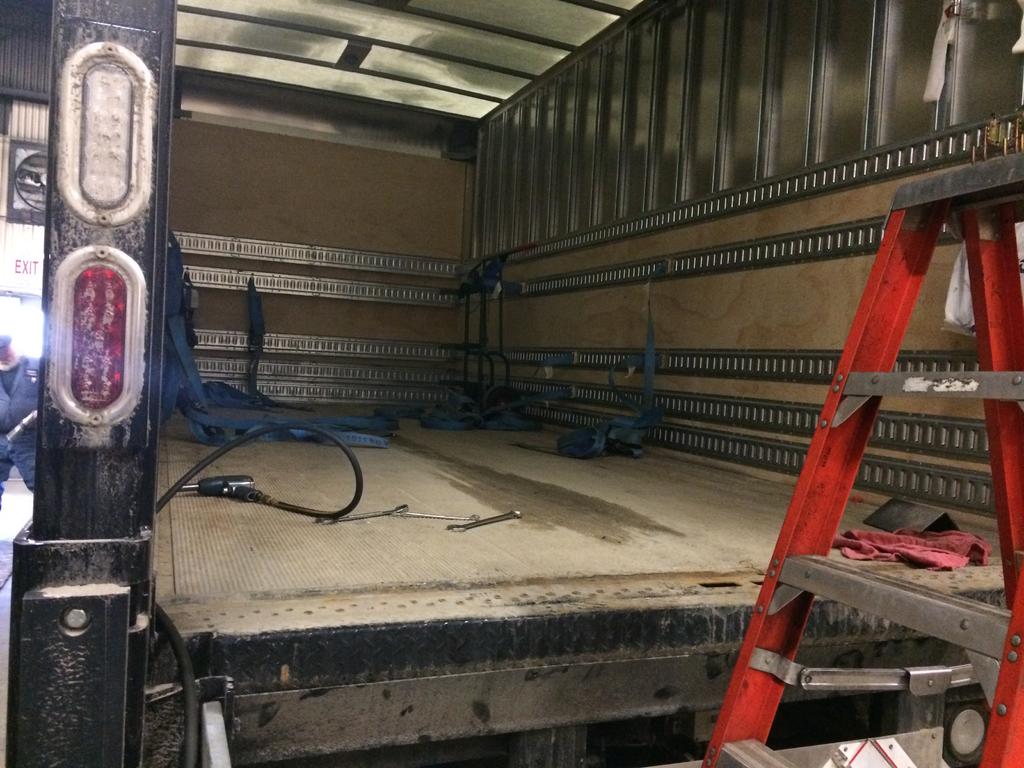

So what product does this truck haul where 5 rows of E-Track are sometimes needed.....
