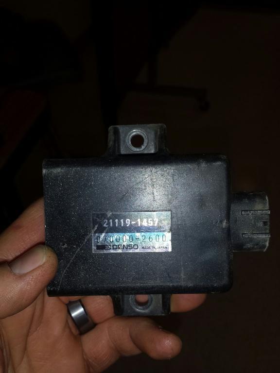

The part number you listed for the exciter matches the part number on my CDI box.

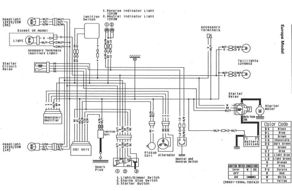

From the wiring diagram in post #9 the exciter coil has a RED and a RED/BLK wire. The drawing in post #15 shows 2 connectors on the stator wiring.

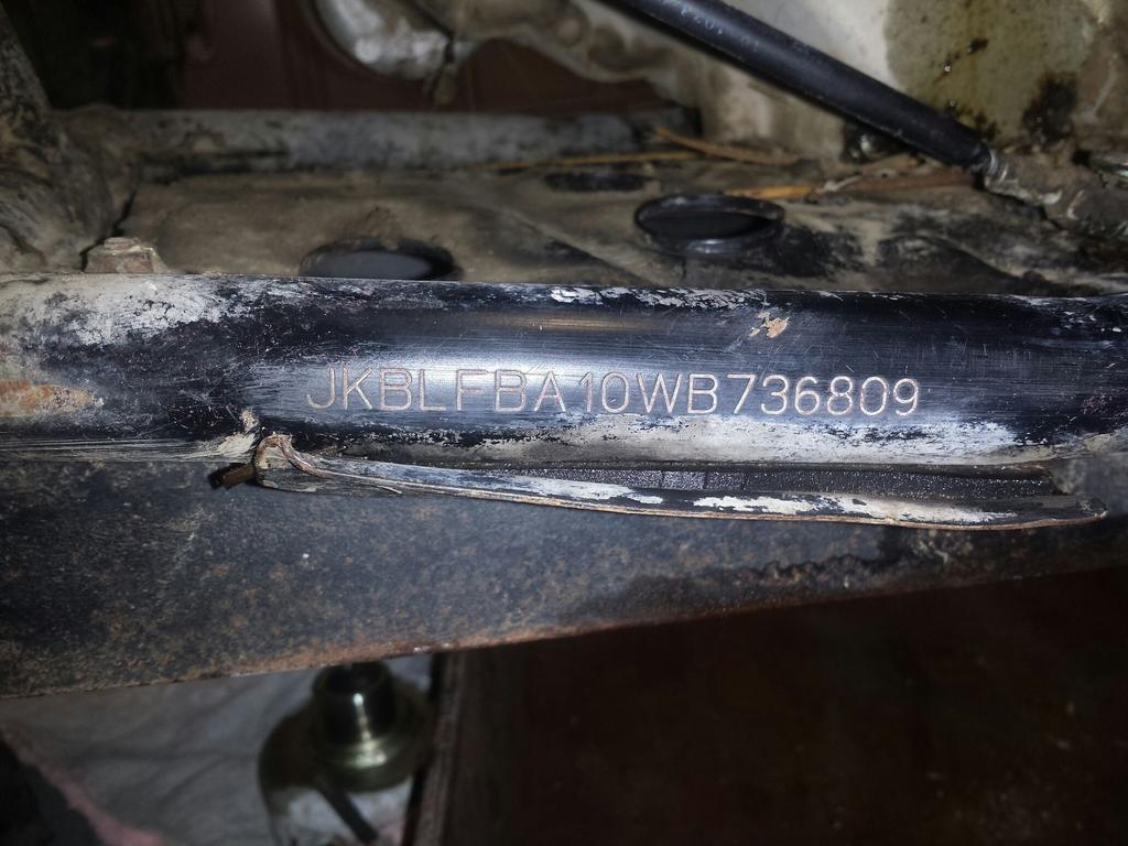

I found a pic I took of the notebook page I wrote the VIN on. There's a chance I wrote a number down wrong so I'll double check it in the morning. What I wrote down is this:
JKBLFBA10WB736809

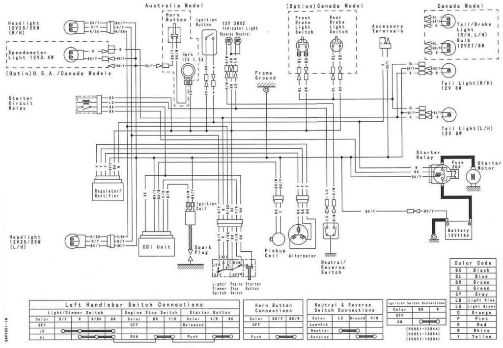

Well, your VIN is good, it is a ’98. I did find a Service Manual Supplement for 1998-1999 models that has the following wiring diagram:

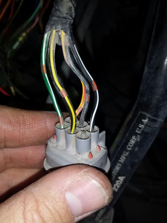

It does show 5 wires to your CDI and it also does not show an exciter coil at all. Guess that’s why we can’t find the wires or connector. It shows the PU coil wires as Black and Yellow from the PU coil to the connector, then Black/White and Black/Yellow from the connector to the wiring harness. From your pics it looks like your PU coil has a Blue and a Black coming from it to the connector.
The good part of this is that it should be even simpler to find the issue. The 5 wires from the CDI are ground, starter button/starter relay, PU coil, engine stop switch (the On/Off switch on the handlebar, and the Ignition coil.

1. I bought the 2nd CDI unit on Ebay and was guaranteed that it was from a running ATV......So for whatever that's worth. I don't know of anyone with a similar unit around but I'll keep looking.

PU coil air gap is listed at .028" +/- .009". I don't see a gray wire on the diagram anywhere which is confusing to me. Do you see both ends of the gray wire where it was cut? Can you trace where it goes on both ends?

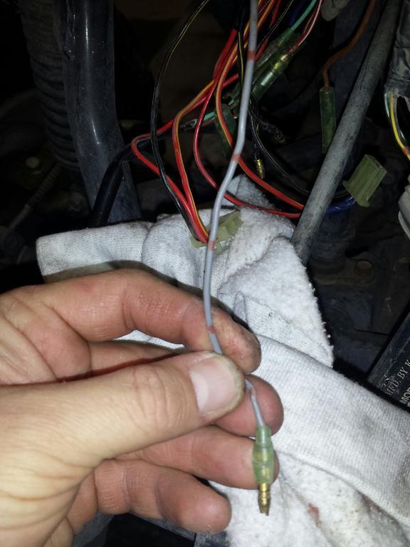

Woodruff key looks good. I'll check the air gap in a few minutes. I can see both ends of the gray wire. There is a few inches of it missing and both ends are dirty like they've been cut for years. The opposite end from the CDI box goes back into the bundle of wires and has a male plug on it. One of those diagrams I posted has a gray wire listed from the CDI box and splicing into a 3rd wire on the ignition switch......my ignition switch only has 2 wires and neither are gray.
If you look at post #19 and the UK/Europe .pdf you'll see the gray wire.
Here is both ends of the CDI box wire connector.
You can see the gray wire that was cut near the box end and the missing few inches of the gray wire. Then at the other end of that bunch of wires is the gray again with a male plug. There is nothing there to plug into except for a brown wire which traces back to the common brown that runs to the ignition switch, reverse and neutral lights, voltage regulator, and starter relay.

The only wiring diagram I see with a Gray wire is, as you said, for the Euro models. From what I can tell, the only real difference between the Euro model and the US model is that the Euro model has a 3 wire ignition switch. How many wires does yours have? Is one of them Gray?

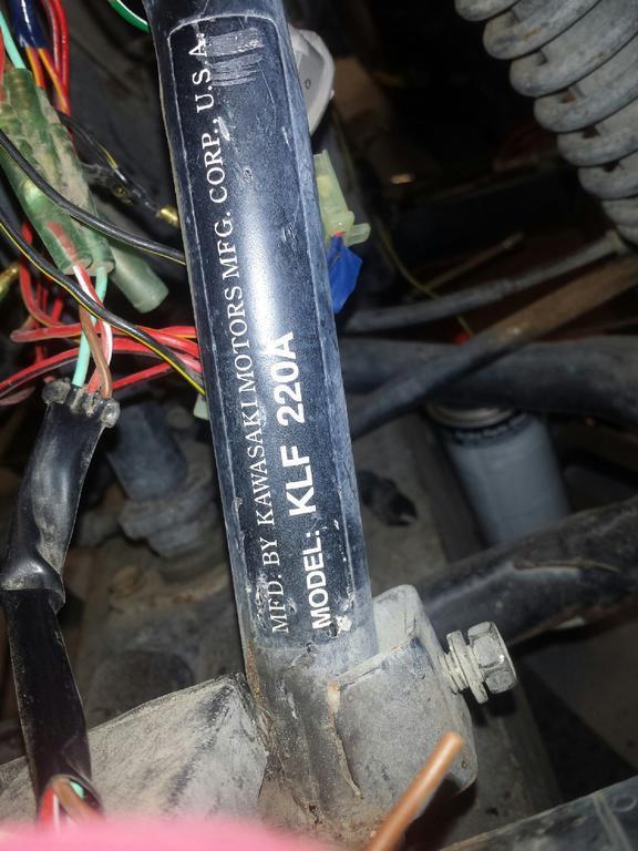

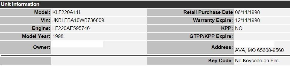

Here's the info on your unit, minus the original owners info that I deleted. I do not recall seeing the "L" at the end of your model number before. I will try to remember to call Kawasaki tomorrow to find out what it is and if it specifies some difference from the standard US model.

Talked to Kawi Tech today. The "L" designates that your ATV meets California emissions standards. He had no idea on the gray wire and confirmed that only the Euro models had the 3 wire switch with the gray wire.
I don't know what else to tell you to check. I'd say just double check all your connections and continuity between all the items shown in the diagram on post #9. I know your wiring is different, so you'll need to use the appropriate diagram for the wire colors. Maybe the CDI you got is also bad? I don't know.

I got spark!!!
IDK what the heck is up but all of a sudden it sparks again! I put the old CDI box baon and now it sparks. turns out the new one I bought is no good after all....but the old one is....go figure.

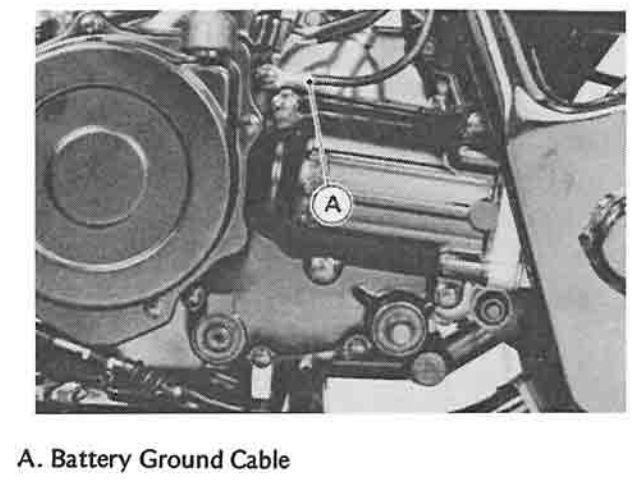

Anyway, I now have all the body panels to re-attach, etc. and can't remember where the ground cable from the battery attaches. Did it go to the frame somewhere or was it attached to the motor?
Thanks again for all the help!
