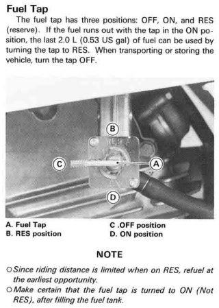

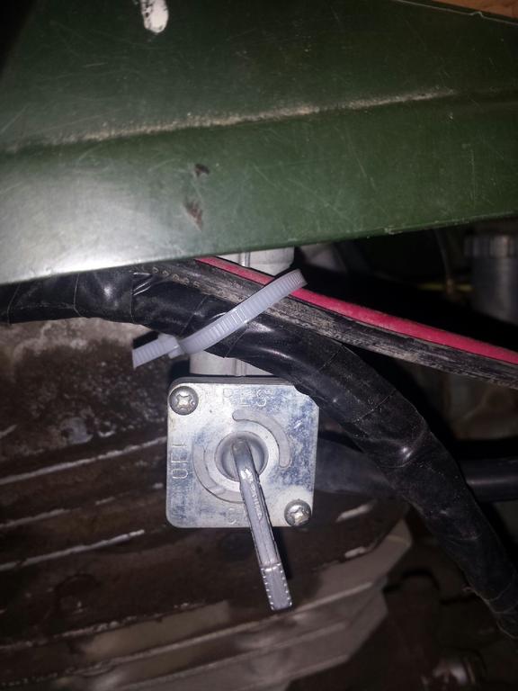

Is this the "ON" position for the fuel switch?
That does help, thanks. I don't know why they can't just put a little arrow on the thing. Or make it so the switch will only turn to 3 positions. Mine will spin 360 degrees
