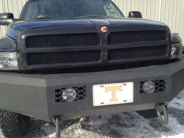

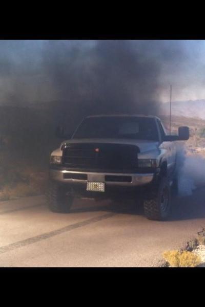

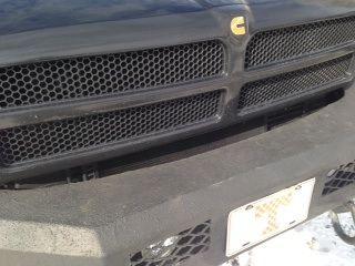

My old truck, with sport grille on it, stock chrome bumper.Somewhere in Nevada now. It will work just takes a little bit of work. Other two pictures are the grille I have now,a black non sport grille.you can see the bumper was made to work with a sport grille. I bought it a few years back from a guy that made it for his 2nd gen sport.When I had it on the old truck it worked perfectly with no gap. Looked at LMC truck but not really wanting to spend what they want. Over $100 for just the bracket is insane. Gonna check out the junkyards
