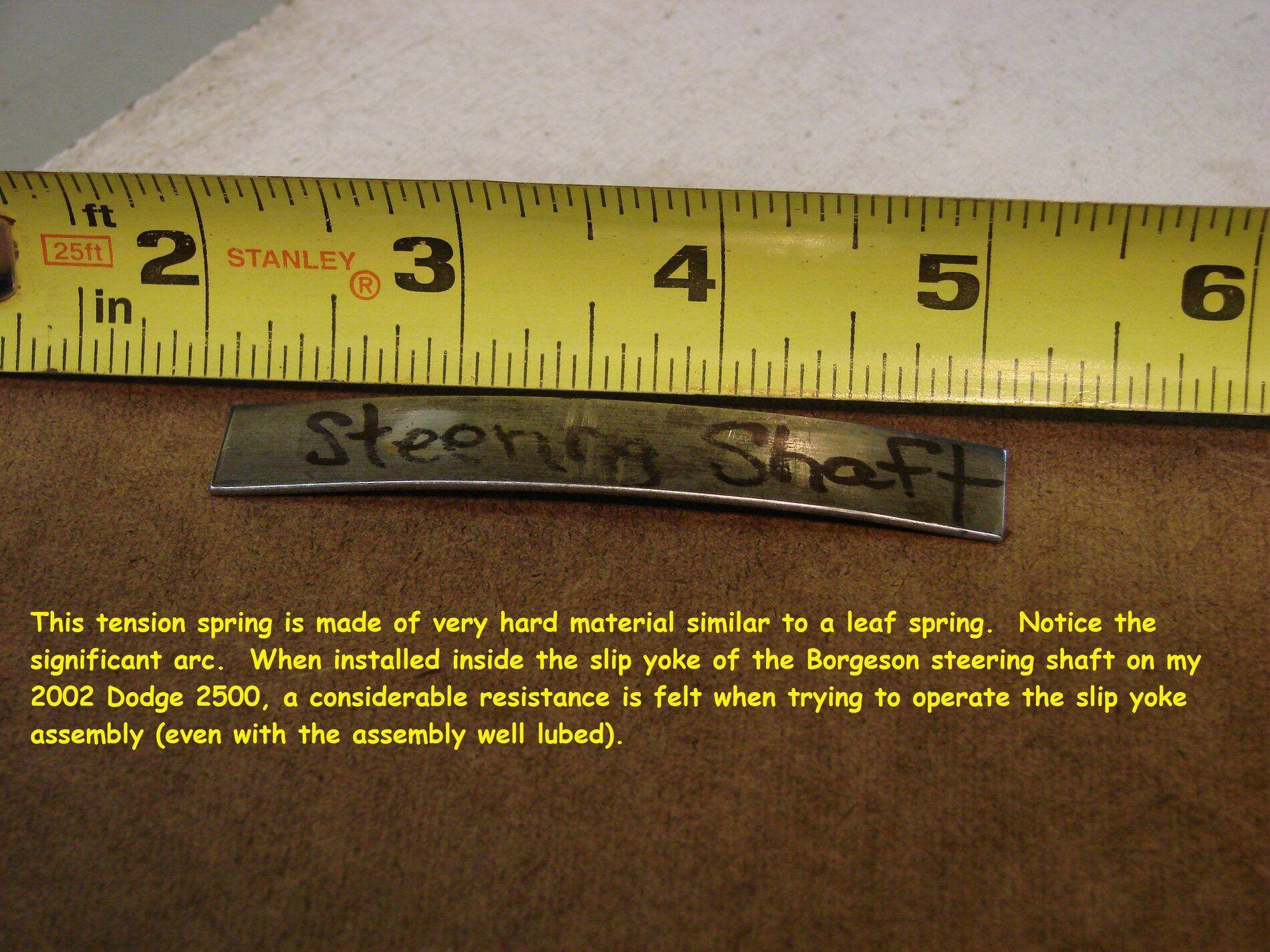

I had a problem with a Borgeson steering shaft that drove me nuts for 25,000 miles. The problem was a tension spring in the slip yoke section. Both pieces of the shaft should slide axially very easily. Mine did not, which resulted in unwanted axial forces on the u-joints between the steering wheel and the steering gear box. This gave the steering wandering symptoms and also loosened the set screws on the steering shaft. I ended up removing the spring. The photo below shows the culprit - this tension spring was inside of the slip yoke assembly and provided for too much tension. After removing the spring, the vehicle began tracking as it should and has continued to do so for the last 60,000 miles.

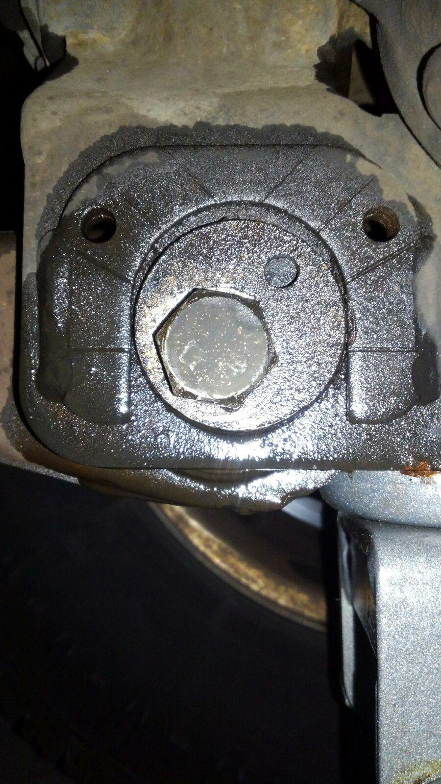

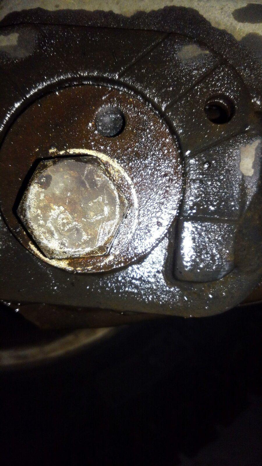

good pics. That sure looks like a factory setting. Yes, rotate your cams to the furthest forward notch. Give that a whirl. It may throw your steering wheel off-center a little bit, but you know how to correct that. I used everything Moog on my front end. Talk about robust. I'm thinkin the 'overhead' adjustment you are referring to is the steering box adjuster. It would be a good idea to put the adjustment back to where you found it Chances are it wasn't the issue, and you don't want to prematurely wear it out. It will damage the sector shaft in your box. Another thing to check with your wife's help: Have your wife turn the wheels under power and turn your attention to the synergy steering box brace. Make sure the bearing isn't binding on the shaft. Mine did it. Scared the crap out of me when it happened, lol. I would loosen it, steer from side to side while you're underneath looking for the sweet spot on the bearing/shaft movement, then tighten. I would definitely try to eliminate the play in the ends of the track bar though. Somehow with different bolts Our trucks are tough, but the front ends will find any wiggle room to make our lives difficult. Just eliminate the possibility. Rich
The caster adjustment was too difficult to manage in the driveway, I can't seem to get the bolt to move with the truck on the ground (unless I'm doing something incorrectly, I didn't read much into adjusting the caster before attempting to do so), so I'm taking it to a lift tomorrow morning.

I will have to look in to removing that spring, I never noticed that there was one when I installed it.
I would test it in the truck first. First, loosen the collar set screw (near the center of the shaft) and slide the collar and the flexible boot out of the way. Detach the upper Borgeson coupling and slide off of the lower steering column shaft. While holding onto the coupling, move the shaft axially in and out of the telescopic coupling - it should move with very little resistance. If it moves easily, then all is well. If not, then I recommend taking the shaft apart to find out why.
This "spring" is actually inside the telescopic portion of the assembly (the part that I called a slip yoke earlier). Slide the collar and the flexible boot out of the way to get access to a limit set screw on the telescopic portion of the shaft. Remove that set screw and then the two steering shafts can be separated. The arced spring should fall out. If you re-assemble without the "spring", you will probably find that the telescopic parts now slide easily. Re-assemble in reverse order and make sure the flexible boot and the collar are installed in the same position.
When I did my repair I even put the "spring" in a press to reduce the curve of the arc to reduce tension, but it still offered too much friction when installed. I elected to remove the "spring".
My truck is an '02, but I think the steering shafts have the same design. The telescopic joint is likely to be working fine on your truck, but if it is not then you will be chasing a steering performance problem for a long time. I just don't want what happened to me to happen to anybody else.

Pull out ONE bolt at a time thats perfectly SAFE -- NEVER pull both bolts or your axle will turn away, very dangerous.
According to your two pictures above, i would set drivers side to the 12 o' clock position and passenger side to 2 o' clock.
