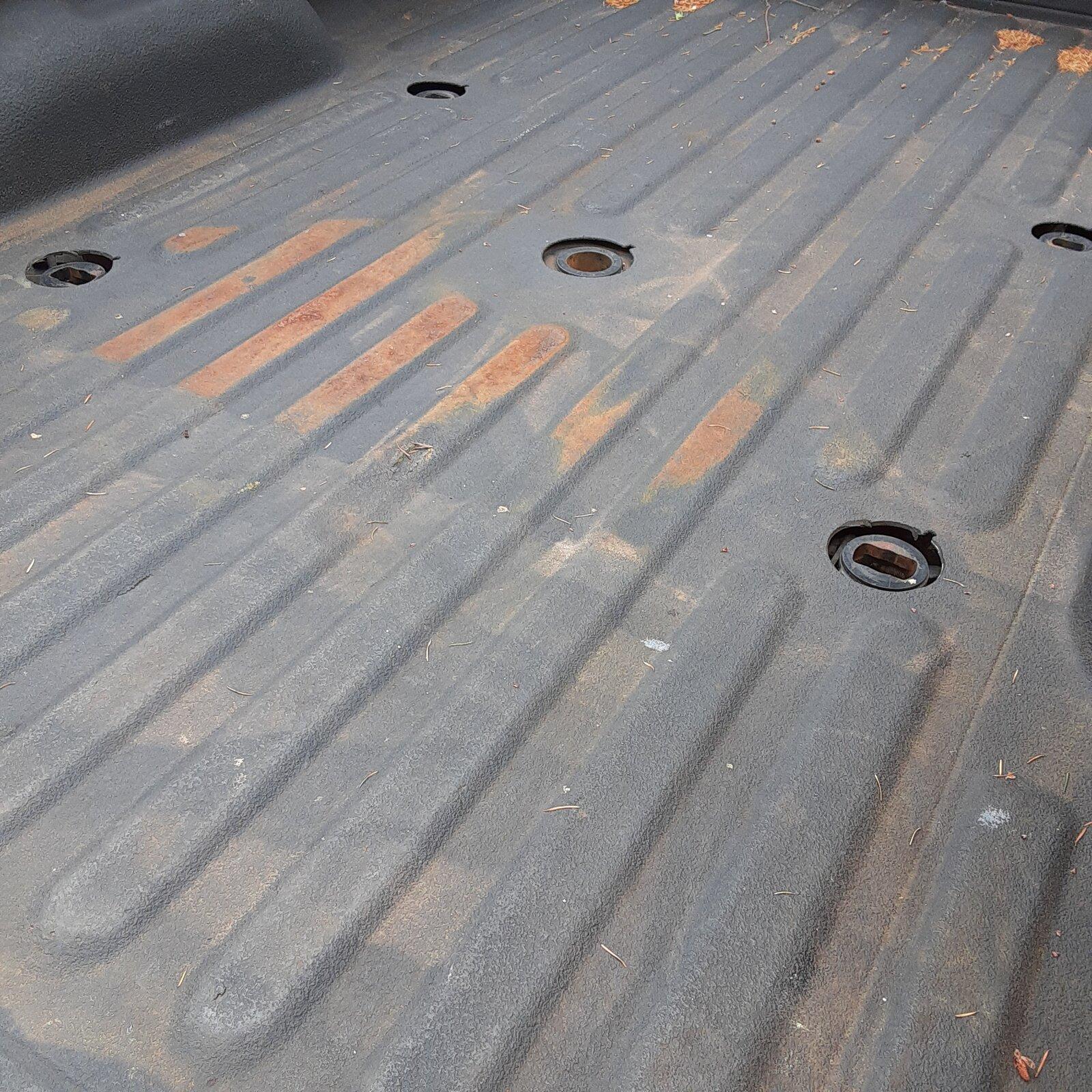

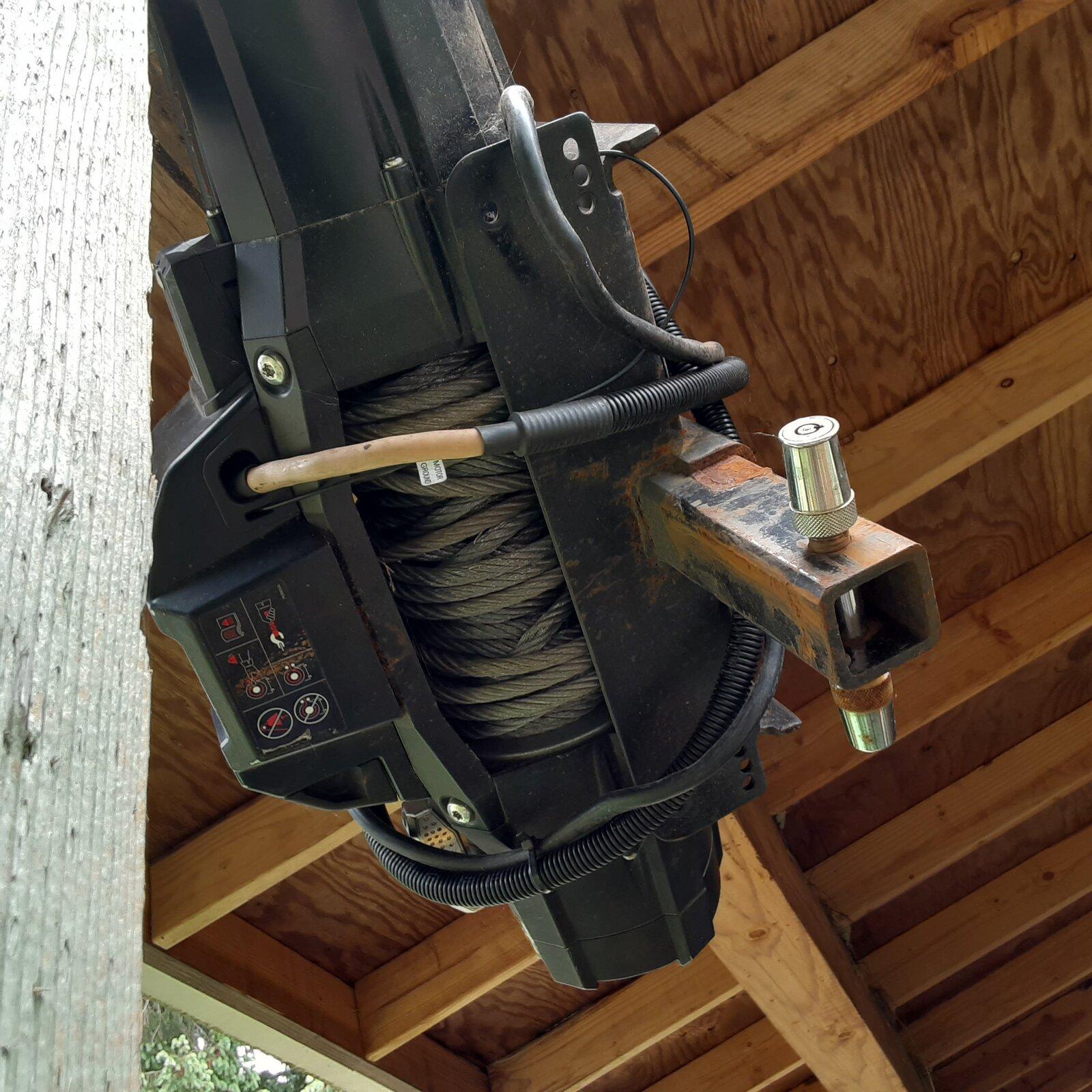

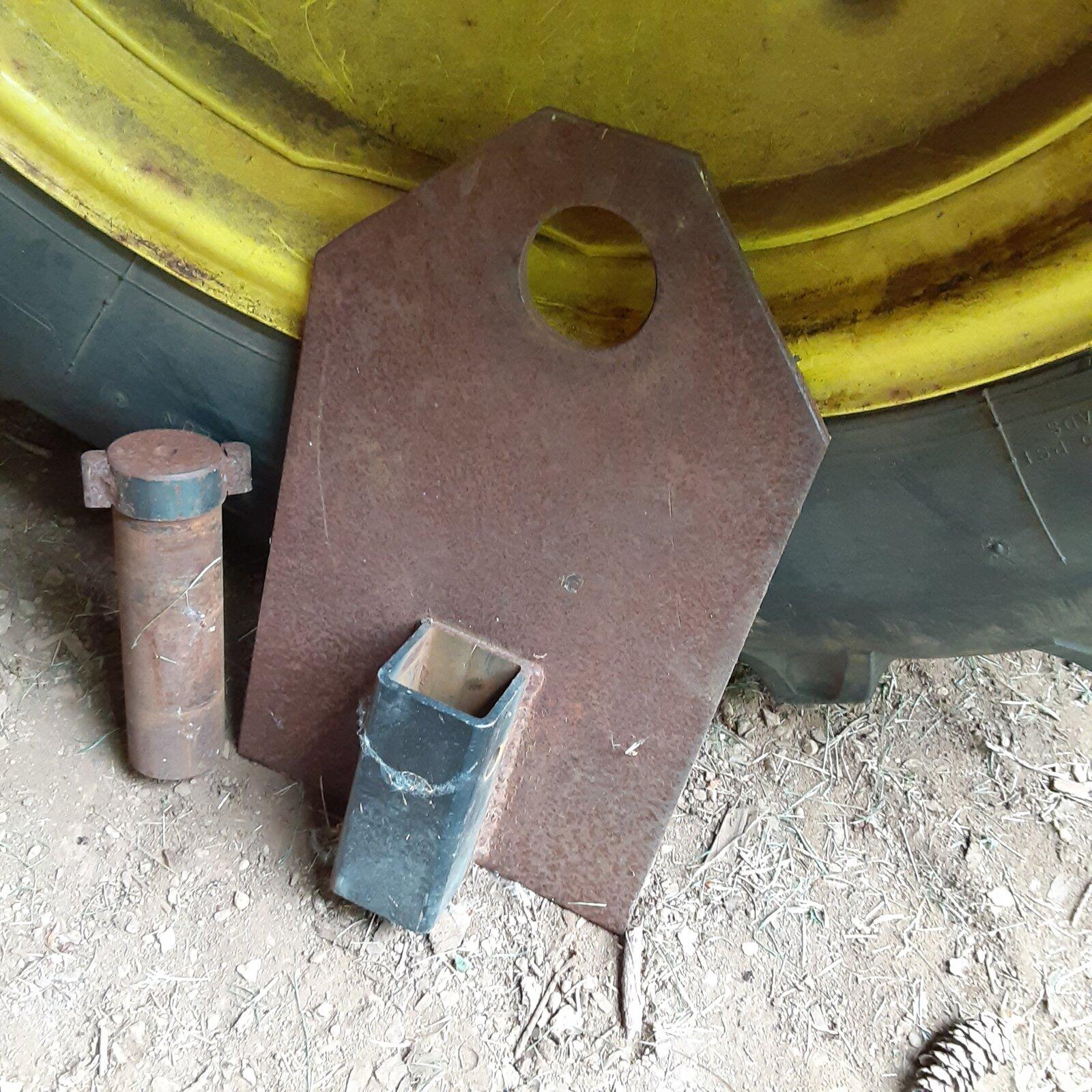

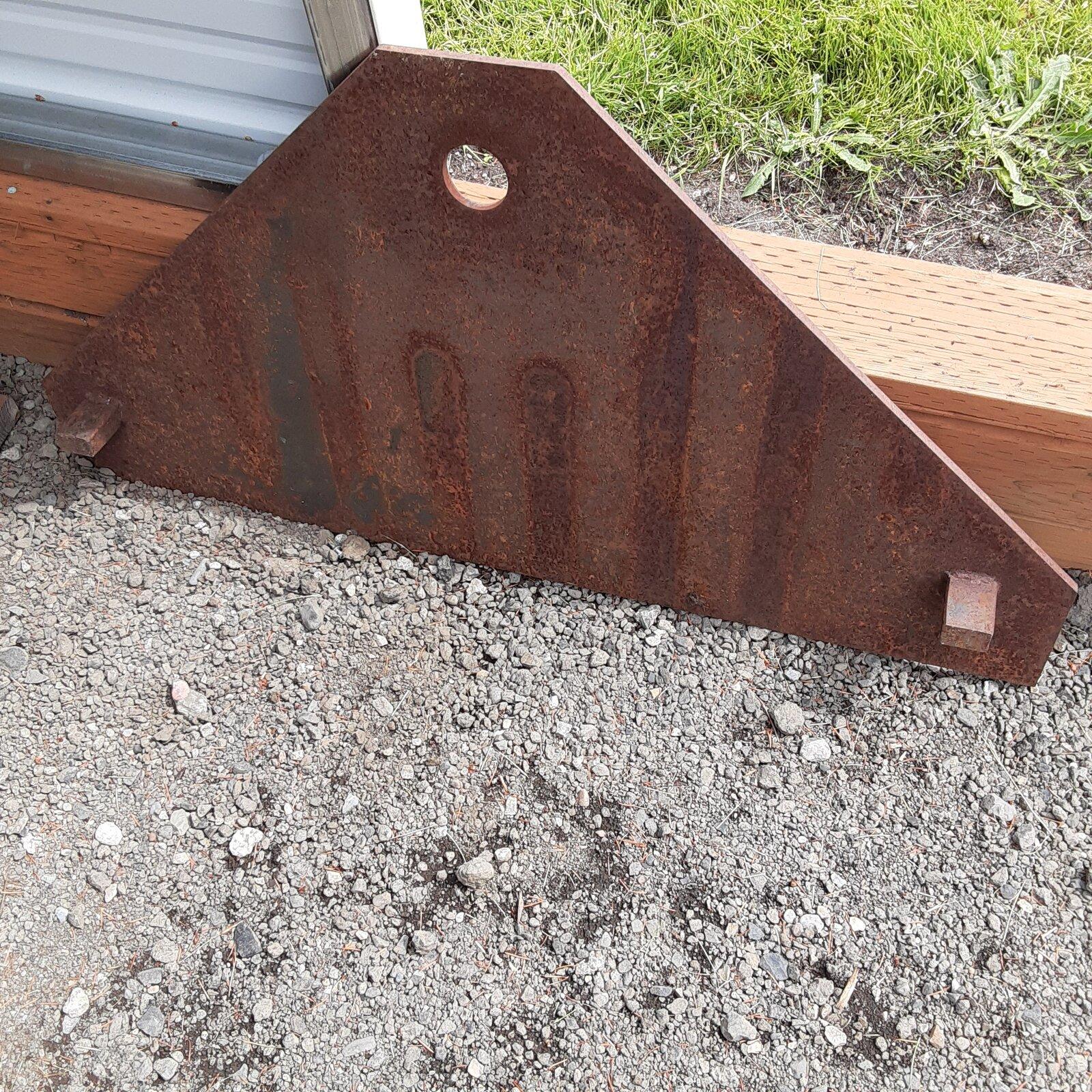

I am currently using the 2 5/16" hole in the bed with a large piece of steel plate (3/8"), same hole in it with a solid round bar that drops through both to hold it in place. There are also two lugs in the bottom of it that set down into the 2 front rectangular holes. There is a receiver welded to the steel plate and the winch slides into that. I hope thats clear enough, it has worked well as the winch can swing a bit left and right. I'm thinking a removeable GN might eliminate that huge piece of steel, just rig a piece of chain or cable around it and pop it out when not in use...

I hope these make sense to you. I think with a GN I can eliminate the big triangular piece and the pin. They are heavy.

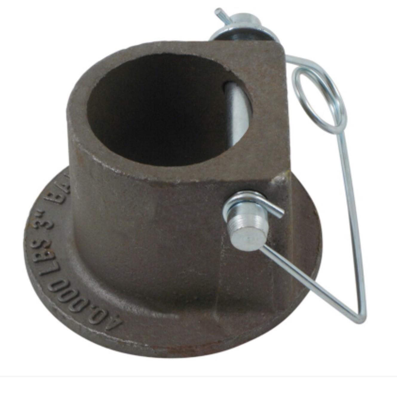

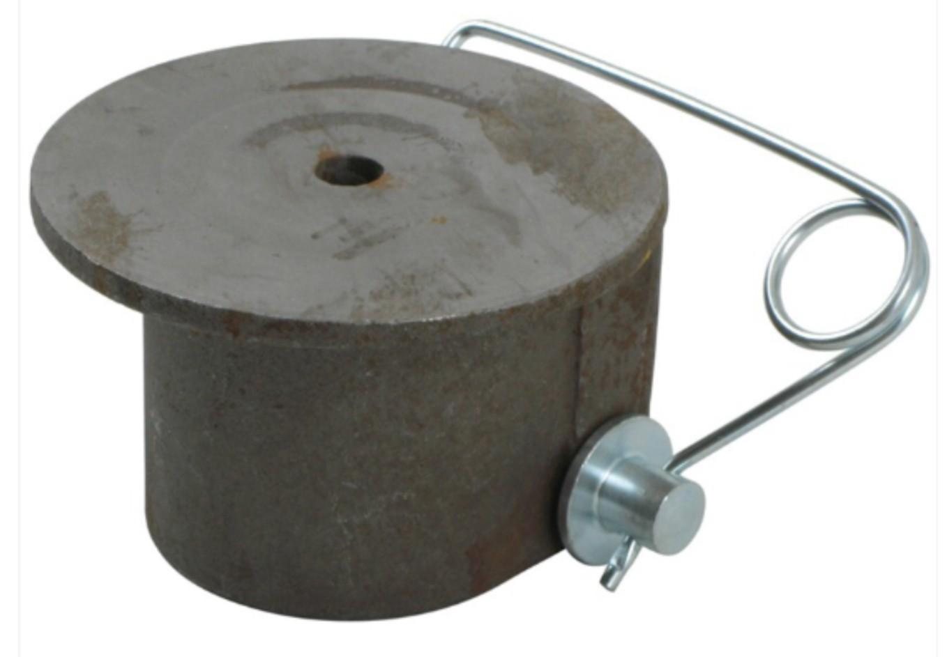

Why couldn’t you get one of these gooseneck coupler heads, weld it to your winch mount, and just put your winch mount on the gooseneck ball?
