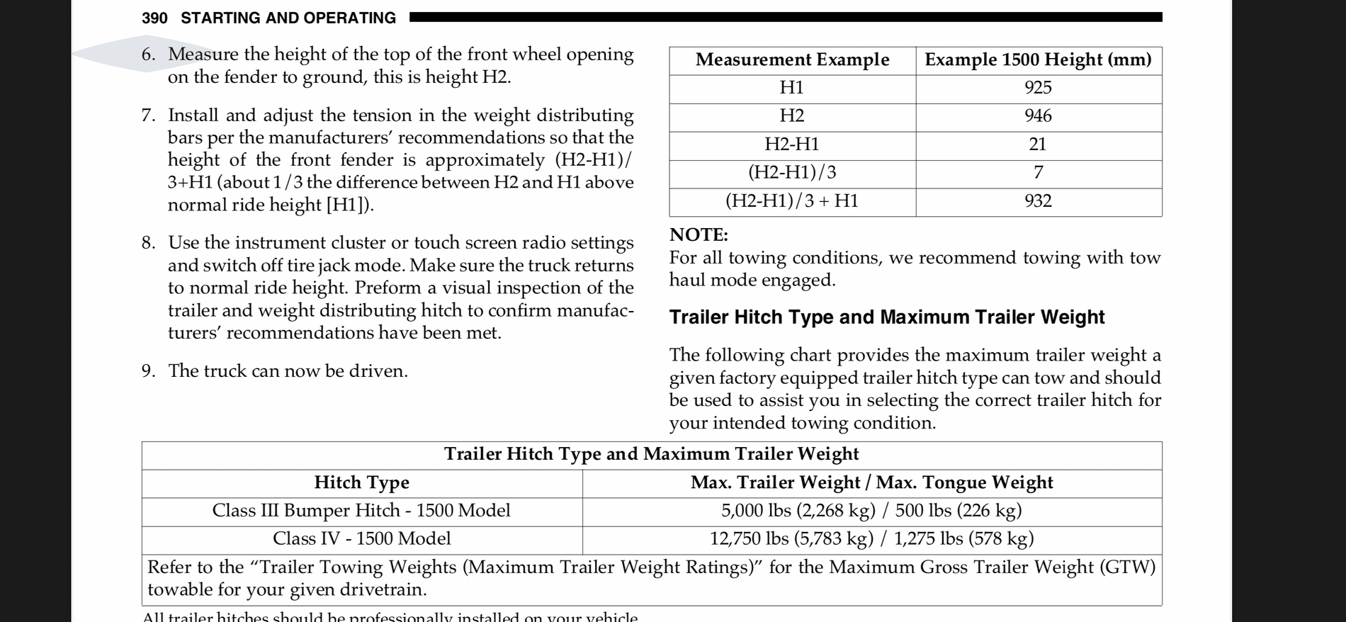

@GAmes I don’t see a 2019 in your sim, but I recall it being the “all new 1500”. If that’s correct the owners manual does have a hitch rating in it. It’s on page 390, and is higher than all but two published trailer ratings for a DT 1500 and it matches those two at 12,750lbs.
https://vehicleinfo.mopar.com/asset...*_gcl_au*MTczMjQ2NjY5NS4xNjkyNjc4NTIy#page388
Thankyou for that. The print version that came with the truck only has 328 pages. I've downloaded the PDF for future reference. It looks like my car hauler with a '54 Ford cargo is well within the ratings.

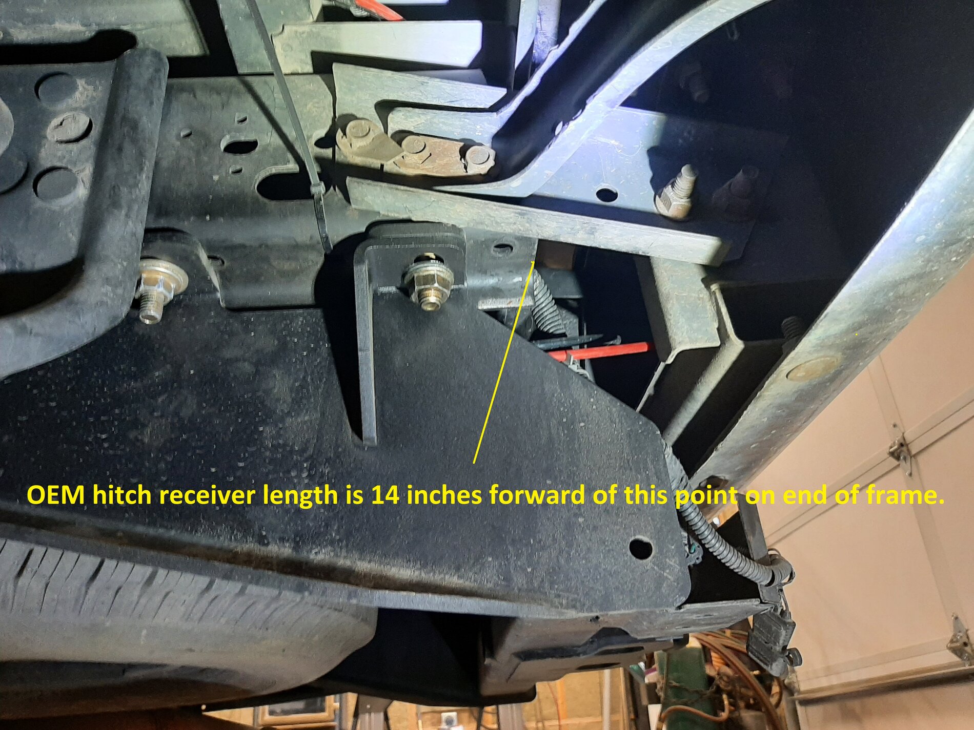

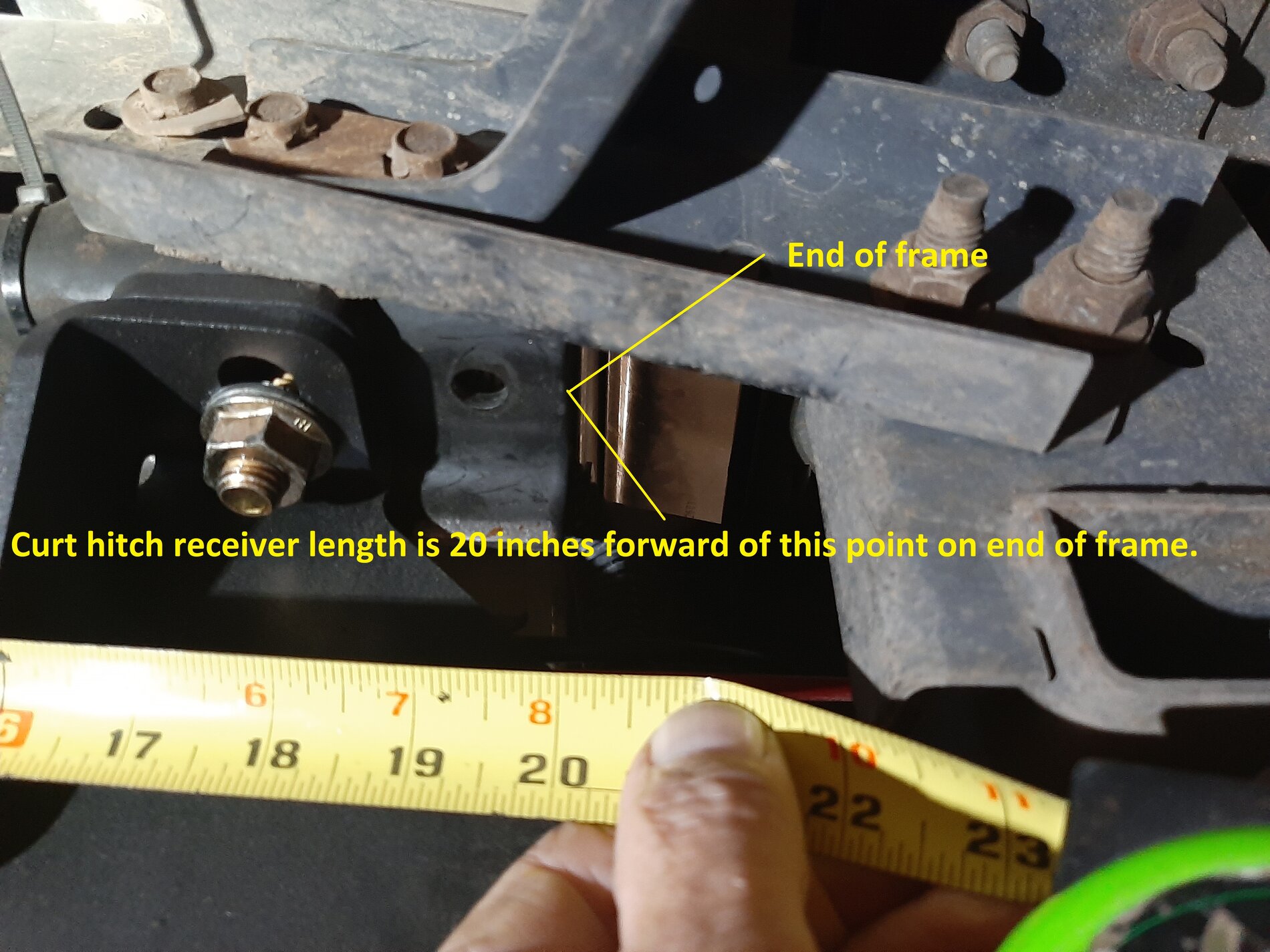

When you installed the Curt hitch, did it fit within the same 'footprint" as the OEM hitch? I ask this because I have a Transfer Flow fuel tank where the spare tire used to be. The space around the tank is really tight. I think Transfer Flow designed the tank assuming that the truck would use an OEM hitch.
The tank can be removed to get access to the hitch and bolts. That's in the spirit of anything can be removed with sufficient time and effort. I'd like to avoid that, because it's full of diesel and the removal process is a bear.
Unfortunately, the Curt hitch receiver is longer. The front part of the hitch receiver is about 6 inches farther forward than the OEM. These photos may help. All photos are viewed from the driver side.
- John
Thank you. I think those pictures will help. I'm going to print them and use them for comparison when I crawl under.

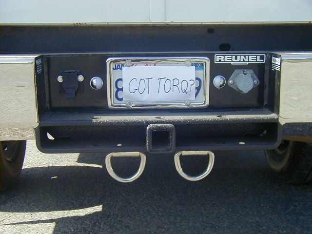

That's why I got rid of the crappy OEM reciever on my 3rd gen and bought a bumper hitch made COMPLETELY from 1/2" plate and 1/2" stainless from Reunel--
Rated for20k tow / 6k tongue weight
Photo doesn't do the bumper justice, and is taken before installing the aux Hella flood lights on each side of the hitch but....
https://reunel.com/rear-bumpers/

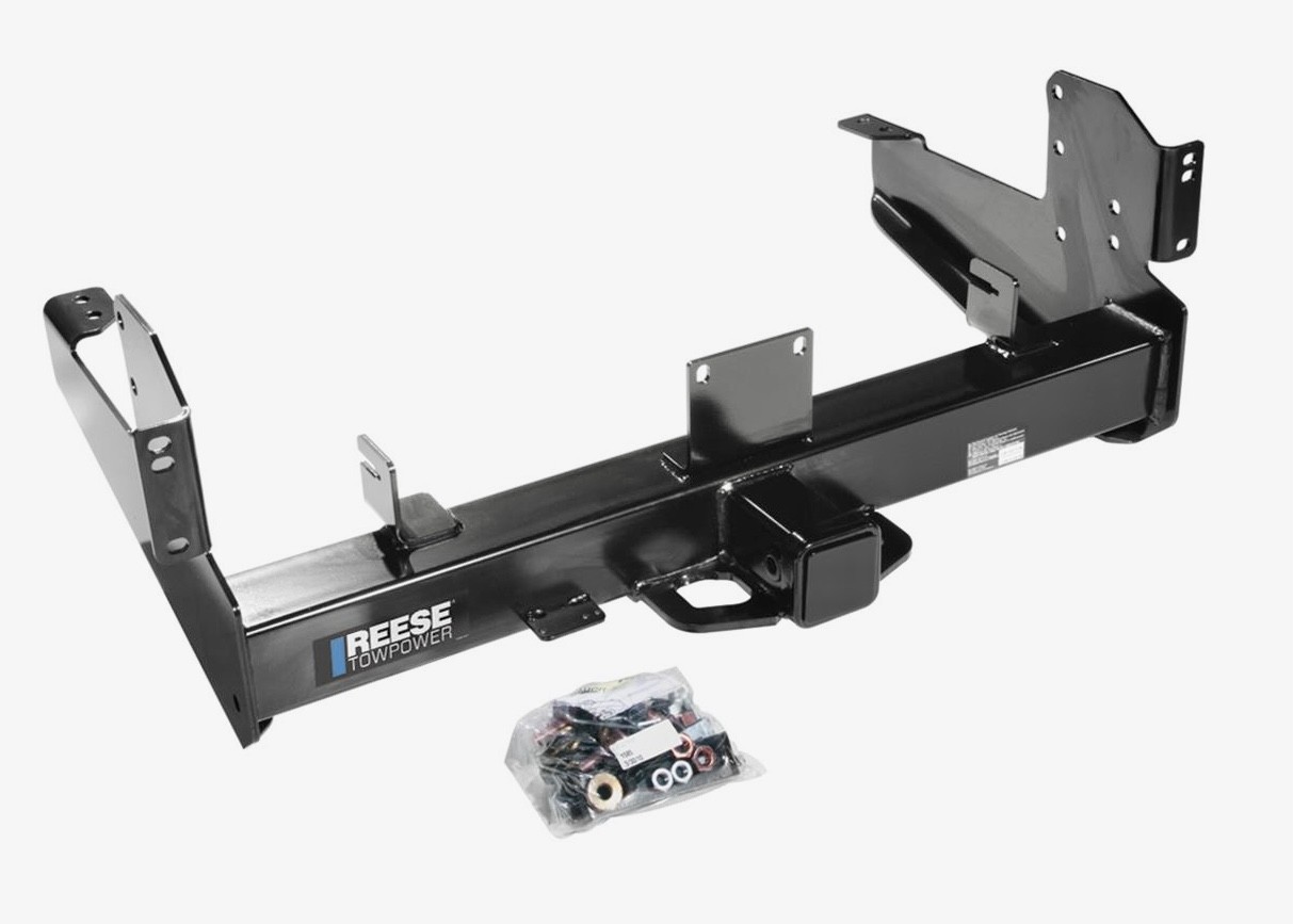

Greatest surface area attachment, as well. I’d not choose other than REESE for a hitch receiver (past something like the proven REUNEL bumper replacement).

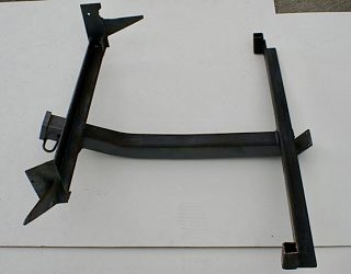

Removing the spare tire to the bed and lengthening the receiver tubing to a second crossmember just behind the Drive Axle would be the strongest receiver, as forces lateral are also problematic.
The combination of these two pics would do the most in trailer control as the truck frame rails are stiffened over the last few feet, not simply the ends. Frame rail twist then doesn’t absorb WD application before the Steer Axle weight drop can be countered.

Seafish: What's the model number of the Reese hitch in your picture? I can't find it in a second generation application.
