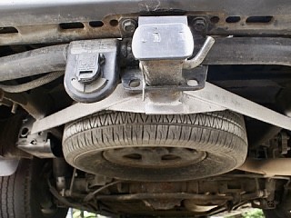

The OEM hitch receiver is better than decorative, but it’s primarily a convenience versus a proper hitch receiver:

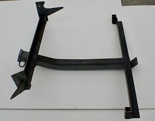

This is a custom-style WD hitch receiver from the good old days. No spare tire to displace. Distance problem from rear axle is “fixed”. (Cross-member & tube end nearest drive axle).
It’s why the dealer popped up with 5er or GN. The OEM (even aftermarket) will still allow the frame rails to flex more than is desirable.
One can fool around with pin shape or sleeves, but for the shank and for the shank receiver one needs to spread the load appropriately. Largest opening, and a receiver which then spreads that load over a larger area of both frame rails using an extended-shank axis such that the load is not concentrated at the very end of the frame rails. (The frame rail ends twist on my KW).
GN & 5’er isn’t superior until the trailer as a load gets fairly high. Location of mount.
Below is how early-ought GM receivers could be braced. The “real” temporary solution isn’t different.
