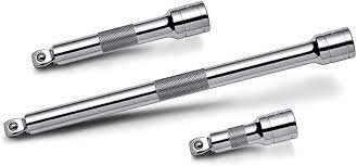

Get a wobble end extension to get the offset as close and you can to the cap.
Yes I did try after a drive and still no luck. Even trying a small impact driver. Can’t wait to see what this is going to cost just to remove a cap.
