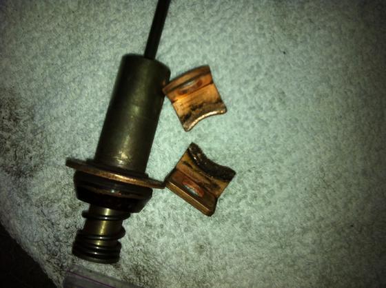

I pulled the starter and found the solenoid contact points were badly worn. One side was pretty good but the other contact was paper thin. I put in the heavy duty contacts and that part is fine. BUT... The actual motor really got hot and stinks like hell. Despite that, it still works! but for how long... ?

Just replaced my yesterday. Parts were locally in Boise, ID.
Hope this helps.
