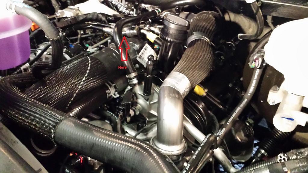

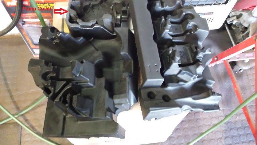

The swirl valve and the distribution flaps get sooted up and need to be cleaned , I've done My ED 3 times in its 38K mile life , Yep its easy for Me and takes about 30 Minutes ,AFTER YOU REMOVE ALL THAT WORTHLESS SOUND FOAM AND BAG THE FOAM OR THROW AWAY. ITS A FIRE HAZARD, PLUS IT KILLS ALL THE PARTS IT Smother to death , I also removed the CP4 sound cover for the same reasons.
