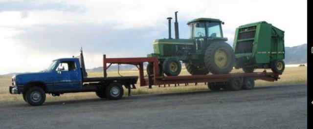

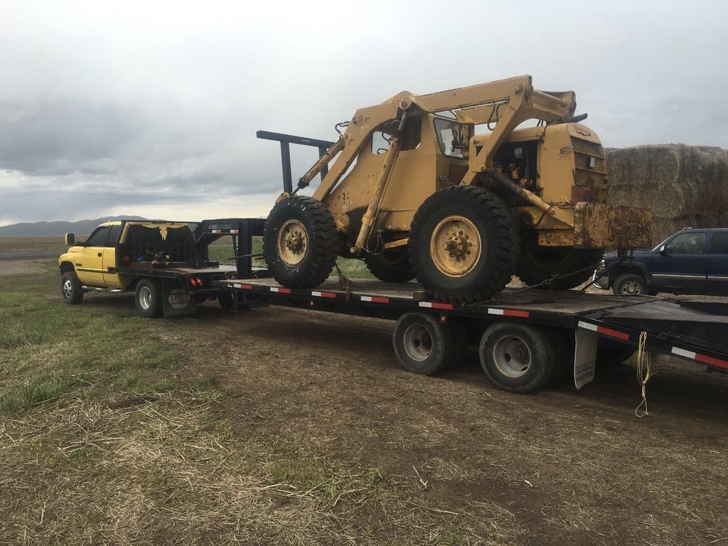

Interesting pics: I moved 4 tractors last Friday to a show venue, a distance of about 6 miles. On Sunday, I returned them to their home(s). None was especially heavy, my Oliver 80 Standard at 4000# is heaviest. Back in July I hauled my "new" forklift home, about 40 miles. It weighs about 7500#; I knew I had a load back there then. Of course, mine is "only" a 3/4 ton truck.
there is no comparison between a dually and a singly wheel for hauling big loads . Although a single wheel will haul big loads to .
