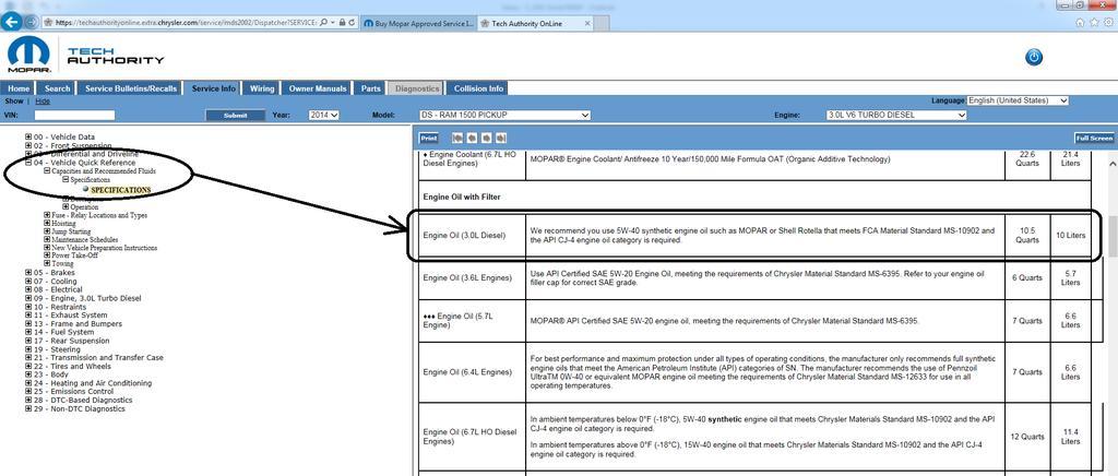

FCA has officially revised the oil spec in the diesel supplement for all year ecodiesels back in July of this year.
Quote from the 2014 Diesel Supplement:
"We recommend you use 5W-40 synthetic engine oil such
as MOPAR or Shell Rotella that meets FCA Material
Standard MS-10902 and the API CJ-4 or ACEA E9/E7 or
ACEA A3/B4 engine oil category is required."
The Mopar Tech Authority Application also reflects this revision.
Here's a screenshot:
I stand corrected. I just looked at TechConnect and the change was also made there. What hasn’t changed is the oil change interval, which they may do later with a flash like on the 2016.
