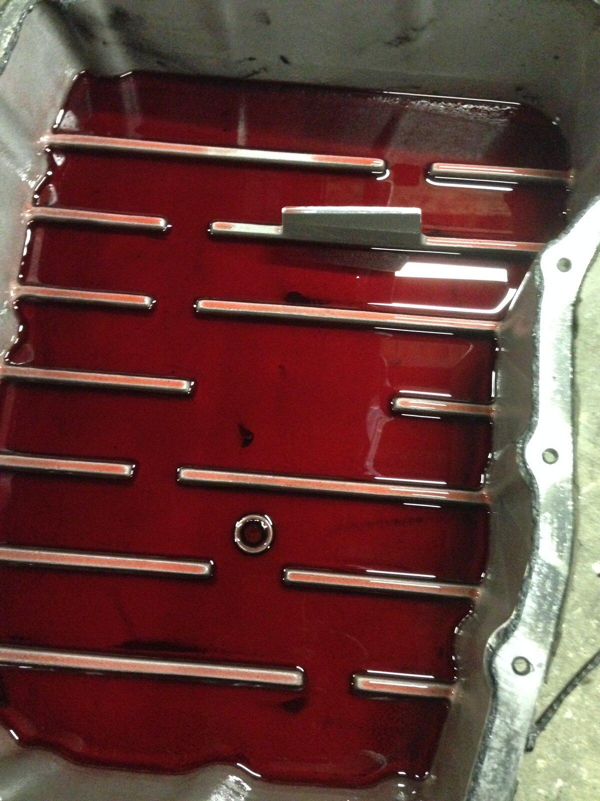

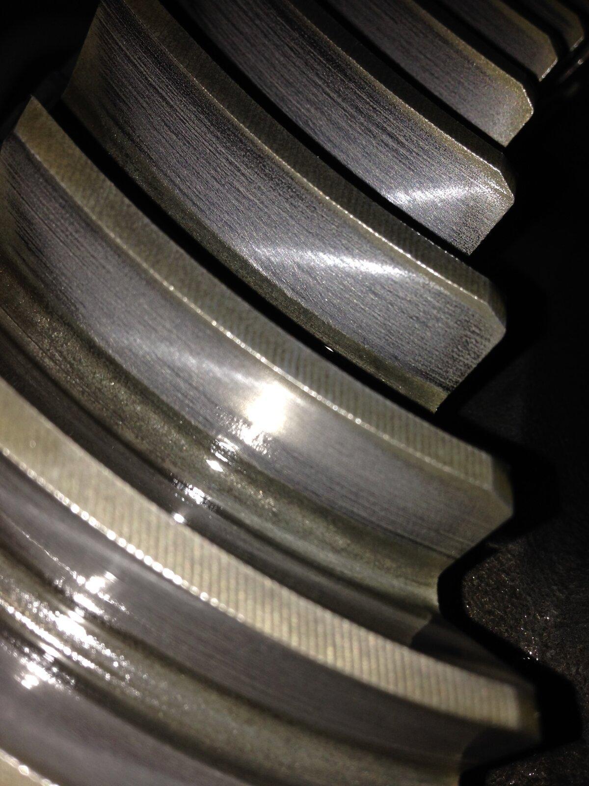

my trans pan was very clean with 55k or so on the fluid. The ring gear still had matching at same with 65 on the clock. If it was an issue those two things wouldn’t have shown so little wear.

Theory is great but I had 65k with plenty of towing time and 72k on current to know they tow the same other than taking off on grade. Yes I have every fill recorded of both trucks. The 2011 averaged 9.5 at 28-29k and current 9.0 at 33-34k. Same roads same conditions.
Here's the trans pan and diff gears at 65k on the 2011. Changed to AMZ/OIL on both around 10k and dumped just before trade in so if there were excess wear it sure would have shown in these two pics. I removed both of the MagHyted covers and re installed OE.
