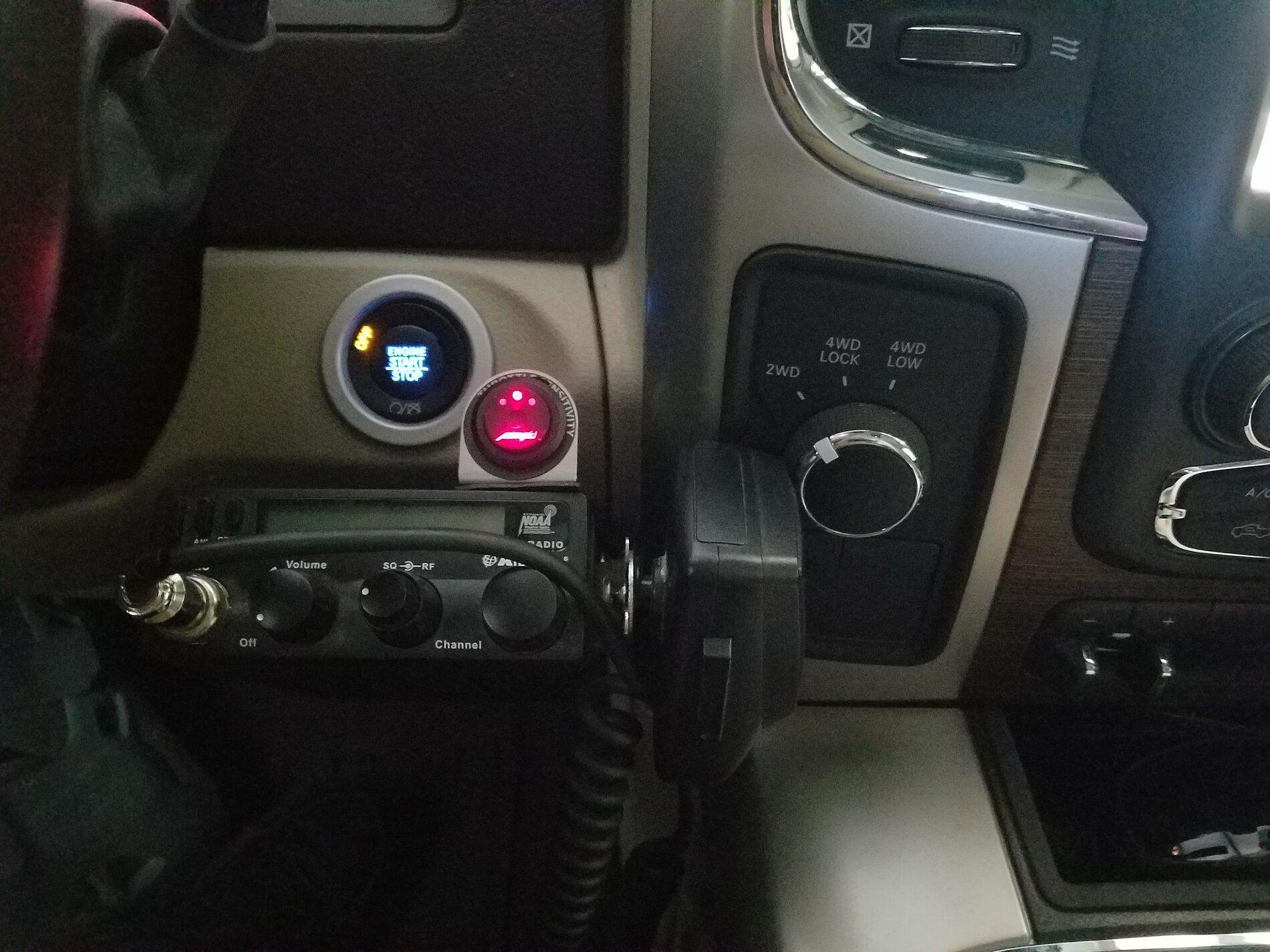

Why I decided on the Edge Amp'd? Switch to select stock, 50, 75, 100, 400, half stock. As you can my switch is very accessible.
So for me for now stock and 75% work. I could see your point if you had one not immediately adjustable going offroad.
Just another perspective.
