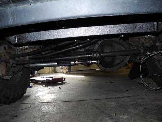

Mopar sells it fairly reasonable, comes as complete assy. , more than likely you will need the pitman arm also. I wouldnt get the stabilizer, way over priced... If your truck still has the slight right hand pull you can use a fox steering stabilizer with a 1. 5" tube clamp (found at offroad shops) and weld a allen head bolt to it for proper positioning, then you carefully let the nitrogen out being sure not to let any oil out and then add nitrogen back in 5 psi increments until the pull goes away... . I have done many trucks like this and works great!(even my dads!) BTW the new steering is slightly bigger than 1. 5" so you have to grind to fit. Placement of the clamp happens right next to the flat spot that the steering stabilizer mount was on.
Mine came with a new clamp that fits the tie rod. You do have to have the new style shock but there are cheap. Dual kits require a new connection system though because the mount is offset.
Cerb... the fox steering stabilizer doesn't work with the mount the steering comes with..... If only I could figure out how to post some pic's... . will talk to the wife, am sure she does...
I realize that hence the comment a new shock is needed. Actually it may or may not work depending on how they did the connection to the tie rod. If the OE stud cannot be removed then it will require some work. My duals did not have a stud so they worked.
Guess i am not sure what you are saying... . Did you read the whole post? I might have been unclear... . Either way you still have to buy a new stabilizer, I was just commenting on how to use the fox stabilizer and the clamp i am talking about is aftermarket.
