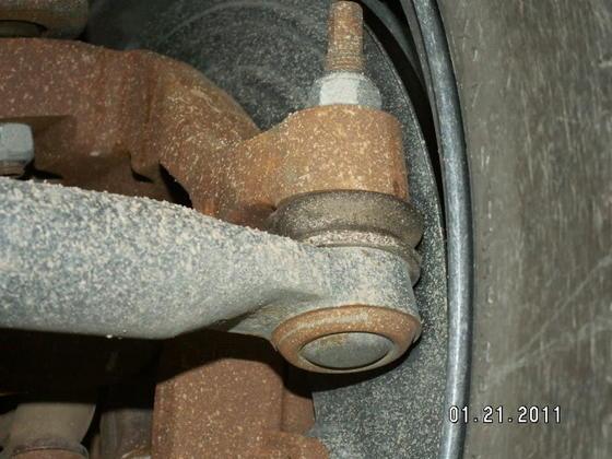

OP quote: "The shop said the nut holding the rod in place just fell off. "
I installed upgraded linkage on Monday. The nut kit supplied contained nylock nuts. Whoever "fixed" the OP's truck probably reused the old nuts rather than putting on new ones to save a few bucks. Factory SM specified torquing the ball stud nuts to 40 ft-lbs and turning an additional 90 degrees.
