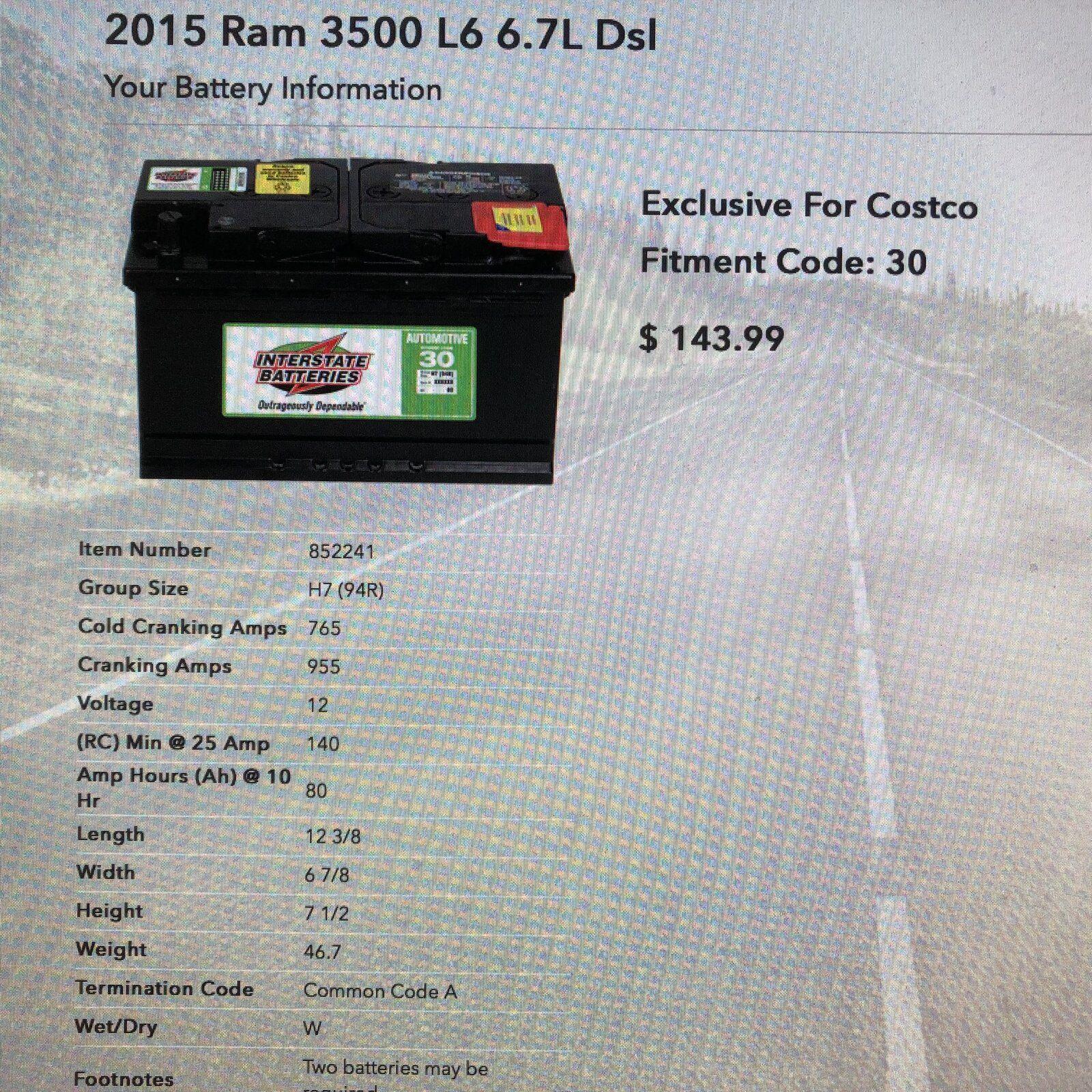

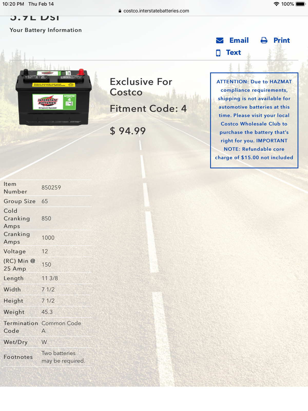

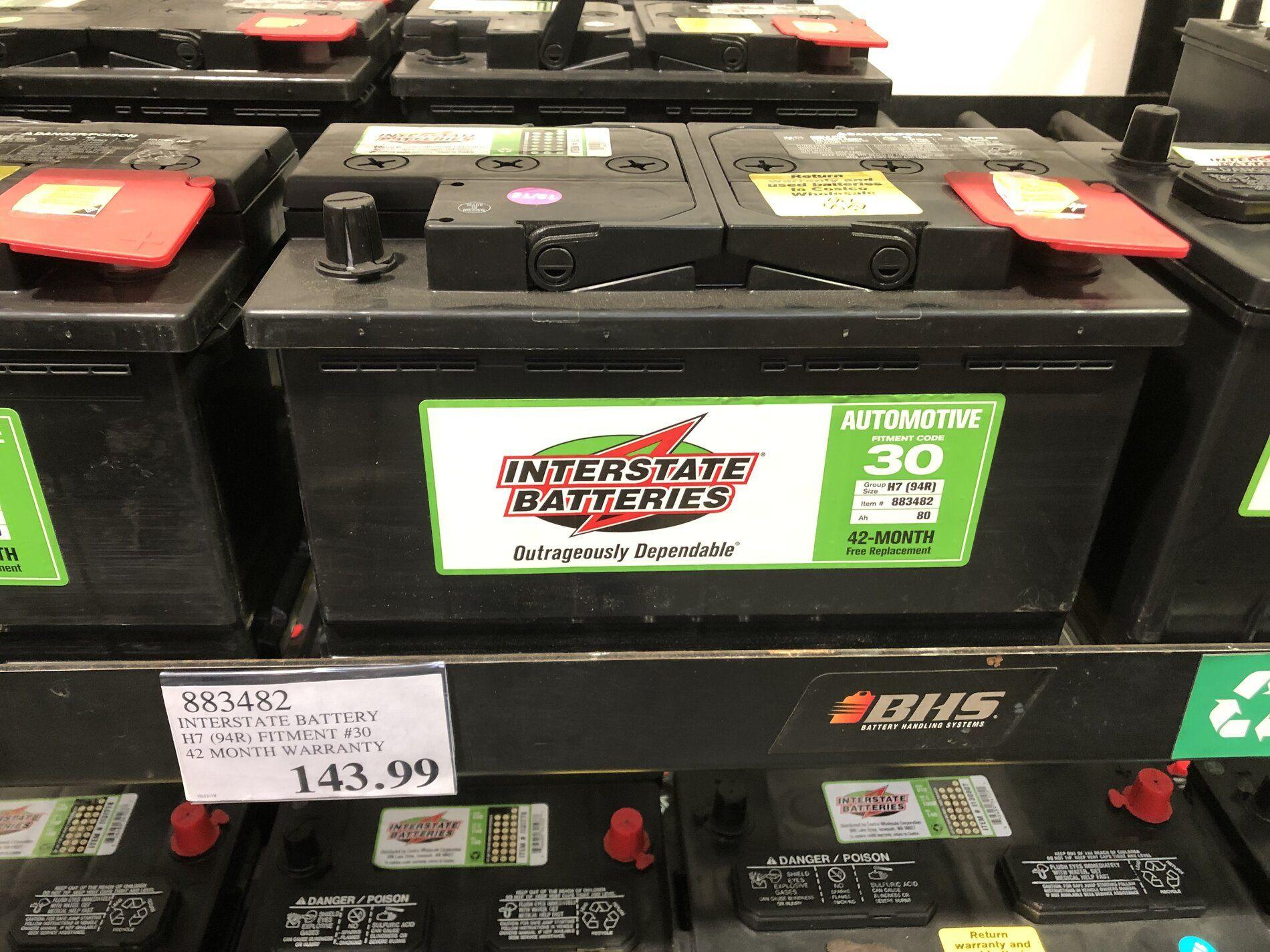

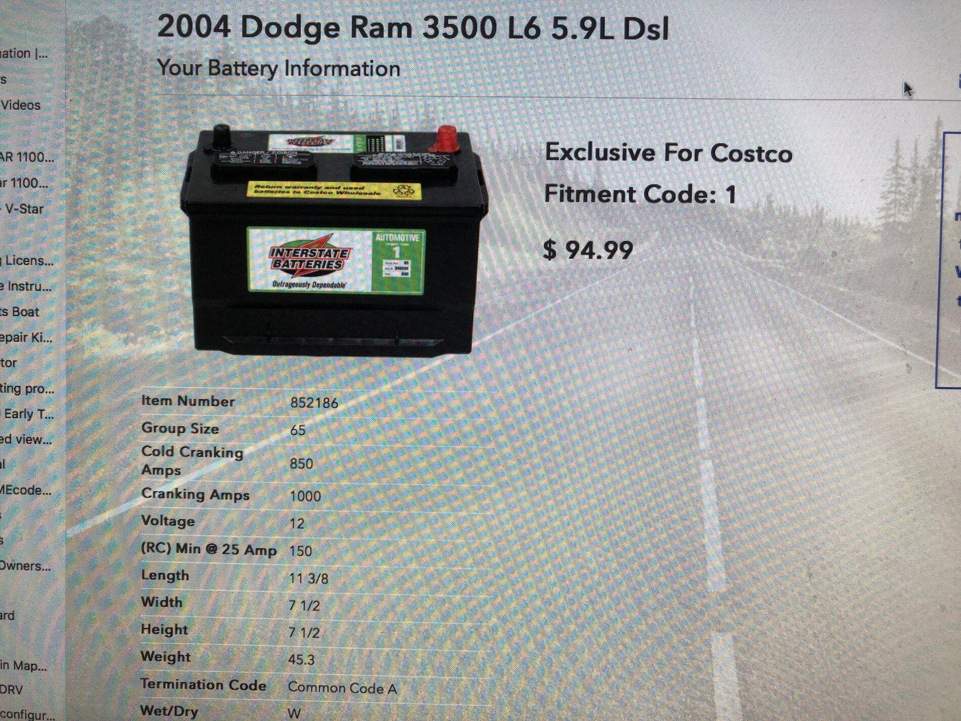

The interstate battery finder vs. the Costco interstate finder.
The above battery is NOT correct for the newer RAM's, it is correct for his 04.5. See below both battery choices. search "Costco Battery Fitment Chart".

Agreed DEKA make good batteries. Where can you get that battery replaced "IF" you have an issue? The Costco batteries are always easy to get replaced. I bought 6v Interstates from NAPA at a ridiculous price and then come to find out they were Made in Mexico.
These have 42 month "free replacement" warranty.

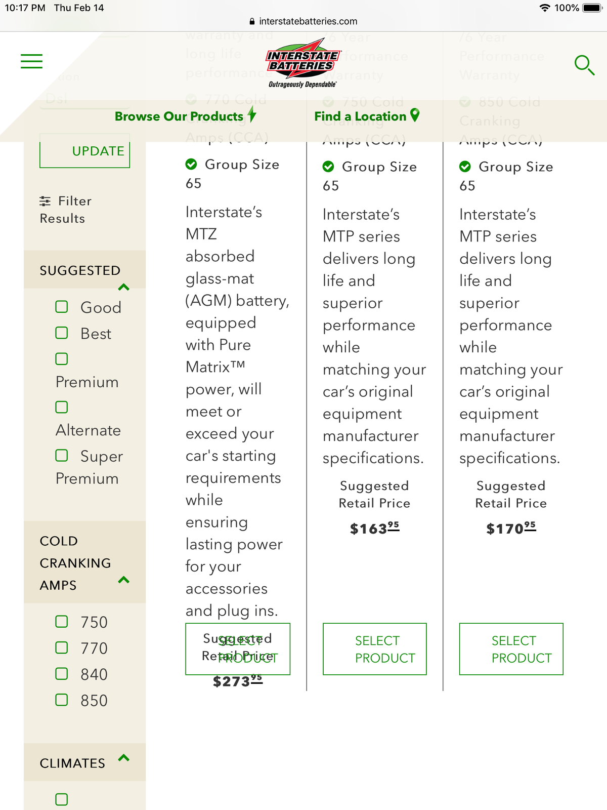

For the 42 month warranty according to Interstate website you have to buy the MTZ line which I think is an AGM?. I'm not sold on them. I'll stick to the flooded.

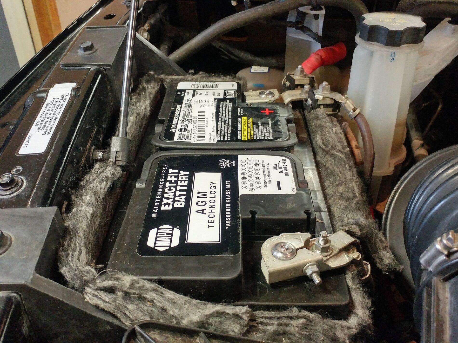

As stated on page 1 of this thread, Napa branded batteries are made by East Penn mfg, otherwise known as Deka. It shouldn’t be hard to find a Napa store wherever you have a problem. They have a nationwide warranty.
Costco has the 42 month replacement NOT Interstate. Another benefit of buying Costco.

This is what I wasnt understanding. If you look at Interstate website only the MTZ have a 42 month warranty. MOST Interstates are 2-3 years and then prorated which I can tell you from experience Interstates protating sucks.

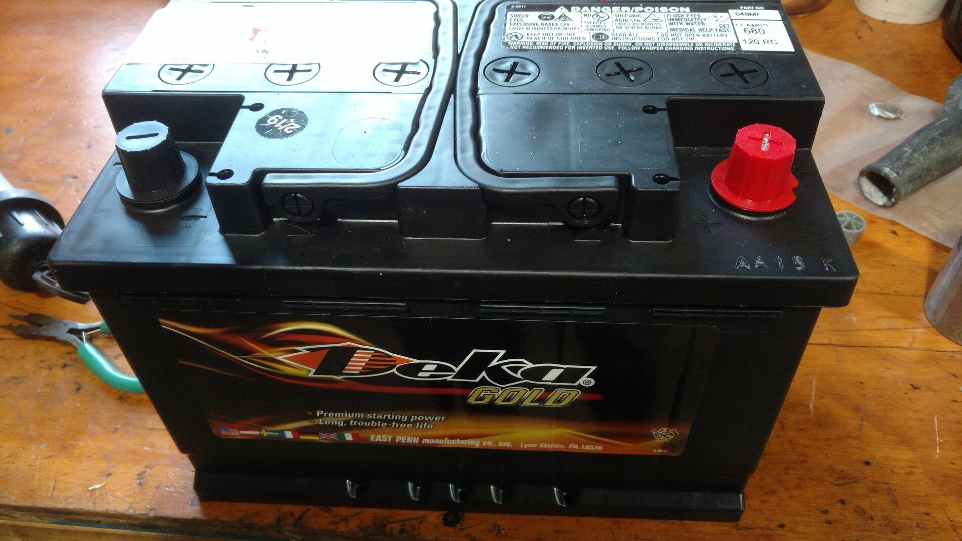

One of the reasons I went with what I did is because Deka has a 60 month warranty. Total replacement (not prorated) Bring it in and take a new one home. Evidently they are confident in their product .

Ordered the Napa branded Deka batteries . $143.00 ea.

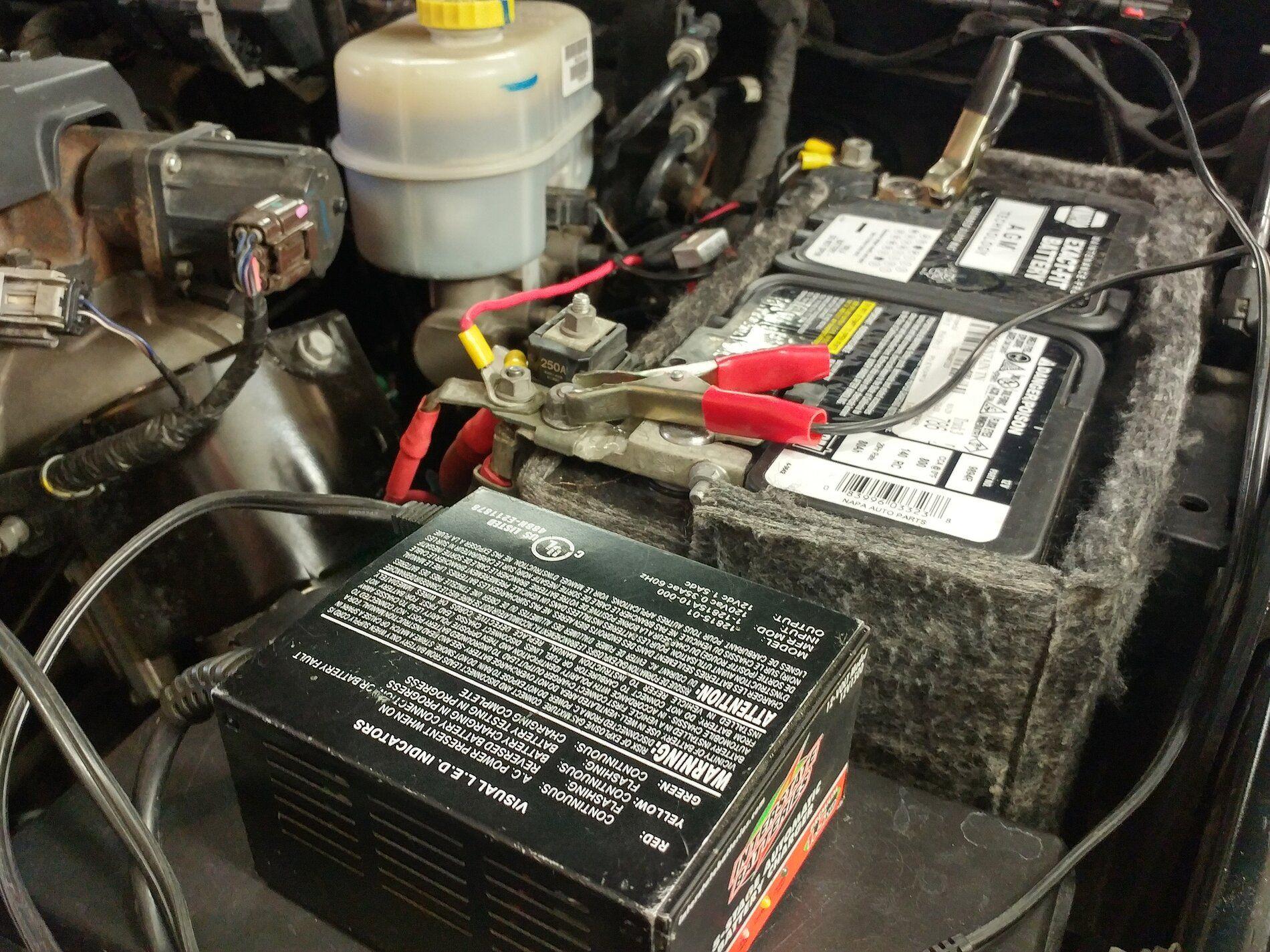

The truck stated acting up this Winter early on. I got the battery saver mode a few times. Started using a trickle charger a couple of times a week all winter. The truck hasn't been driven much lately. Got a 2nd vehicle. Anyway 2 days ago I started it and got the (Service electrical braking system) reminder. As I went down the road I noticed the tow/haul wasn't working, and also no exhaust brake. Once I stoped and cycled the ignition a few times it all started working again. Went to town yesterday, and same thing.
Today loaded up the truck for a trash run, unhooked the battery tender, turned the ign key on to start and it just clicked.
So there are a couple of things that can be triggered by low Batteries. At least I hope that's all that is wrong. I'll know tomorrow.
