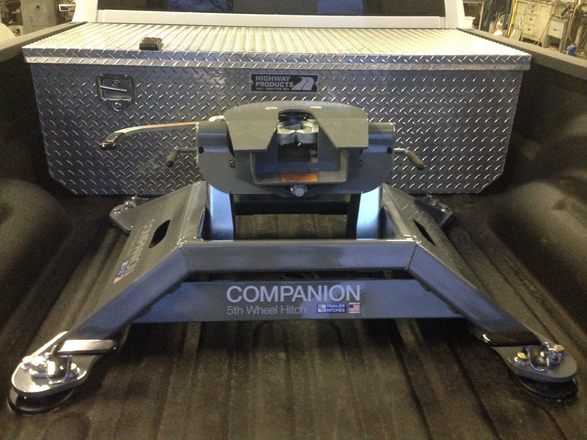

Here are the TWO and ONLY mod's I have added to my truck. 73k on my 15 DRW, tows my 35k combined double tow great in any conditions, road or weather. I maintain it with RACOR, MOPAR FleetGuard and AMZ/OIL products.
