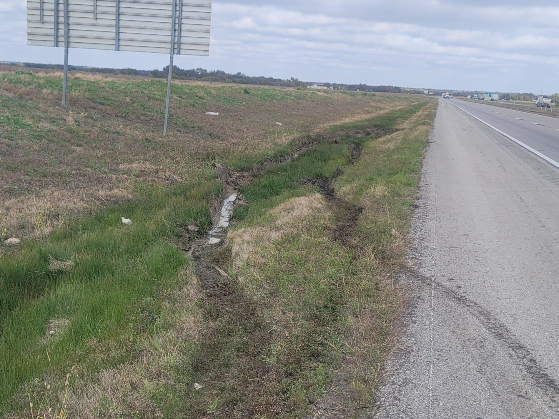

There is one variable unaccounted for that preludes my shifting issues with both the South Bend Clutch dual disk and single disk. My Spyntech locking hubs. I was thinking about this earlier as I found myself laying frame (like all the pretty Chevys I see down here) stuck in mud in a highway shoulder. I was on my test drive this morning and an important call came in from a relative out of the country. I pulled over quickly and thought to go onto the grass as the two lane highway was moving pretty fast. The grass was a trough of deep mud. Nothing I did was moving me as my right side wheels were churning batter. A class 8 truck driver pulled over and yanked me up and out God bless him. I wish I had the cash to give him for his time, but I'll just have to pay it forward to someone else when the circumstance allows me.

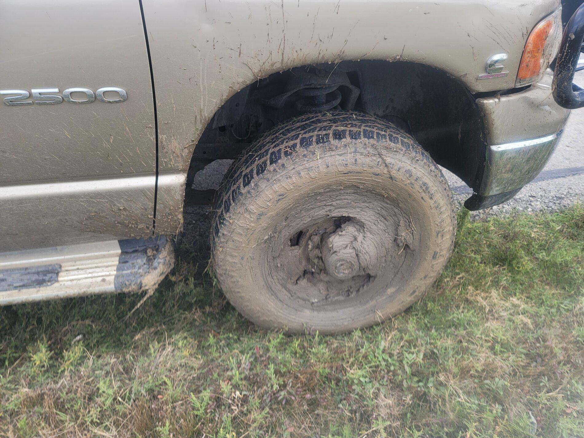

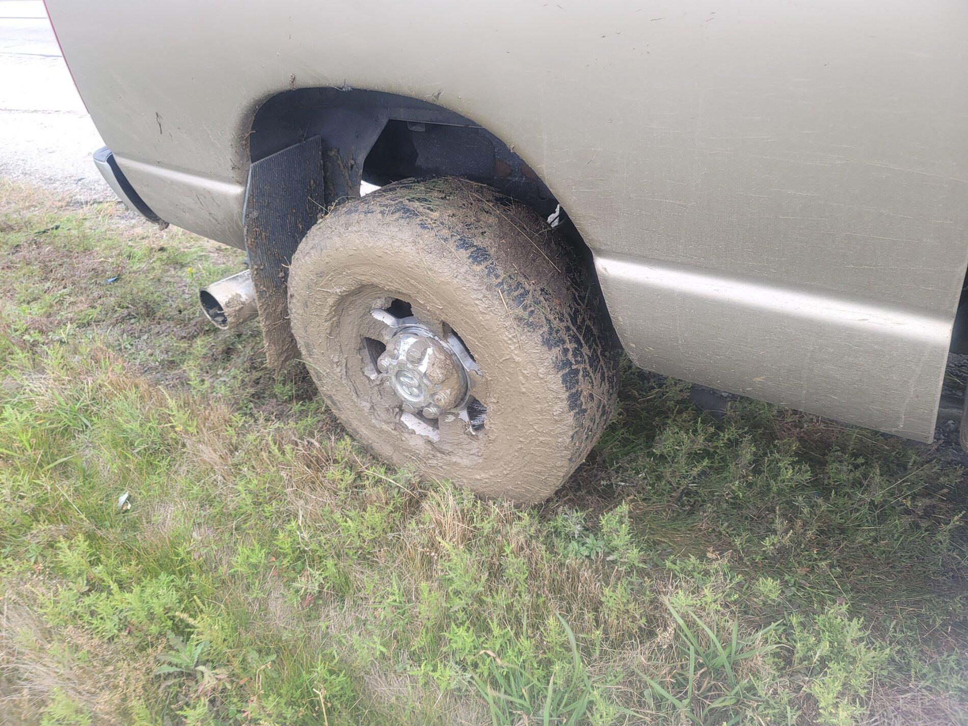

Here are a few pictures of my truck with "Texas" mud for your viewing pleasure. Tire( Toyo Open Country AT 2s) pressure was 55/50 as per recommendation in a different thread. Enough mud packed my right front wheel to cause an imbalance.
View attachment 131572 View attachment 131573 View attachment 131574 View attachment 131575 View attachment 131576 View attachment 131577
Are you still running stock differentials? The stock front differential is open and worthless in mud like that. Even the stock rear end with posi is questionable in those conditions. Ask me how I know! :( Probably no reason to have the hubs locked on the highway unless in snow or ice conditions.
Stock 3.73s and a rear Anti spin torsional according to the Vin build sheet, I resealed the front diffs leaking pinion and it has new fluid and a cover gasket. Rear has fluid topped off, Rear axle has new hub bearings and races. Nothing else done.
