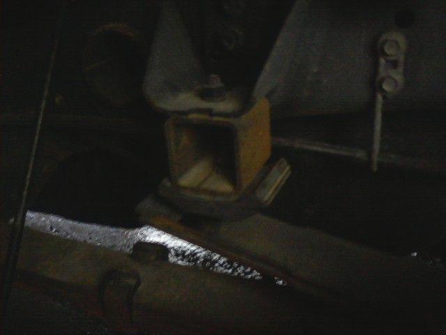

You don't need the frames for the Stable loads. You have two options on installing them on the '05 3500.
1.) Remove the wheel well lining. Remove the existing bump stops. Replace them with the Stable Loads.
If you want to engage the stable loads even earlier then use option 2 like I did.
2.) Remove the wheel well lining. Remove the existing bump stops. Spray a silicone lubricant on the existing stud in the removed bump stop and pound it out. Thread the stable load stud through the hole in the original bump stop and mount them back into the location of the original bump stops.
The bump stop to the rear with the Stable Load will look like this when the truck camper is not in the back:
#ad
The forward bump stop is more difficult to see.
Note: you can install the bump stop to the rear without removing the fender liner, but the bump stop towards the front is much more difficult.
I have these on my truck also however I did't leave the original stops on. I may revisit this and put them back so they engage earlier. I am happy with how they work as is and the truck drops just a couple inches with an 11' 6" Lance on the back.
