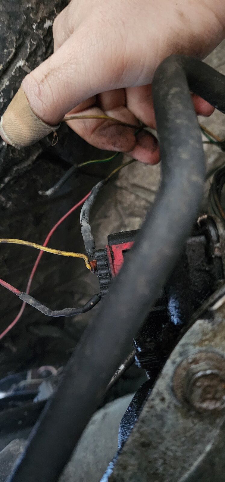

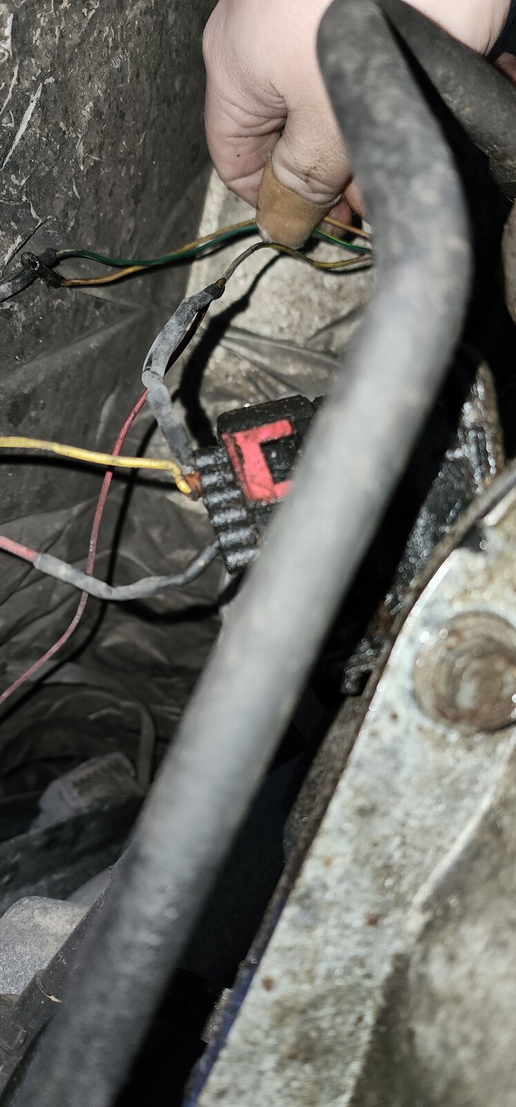

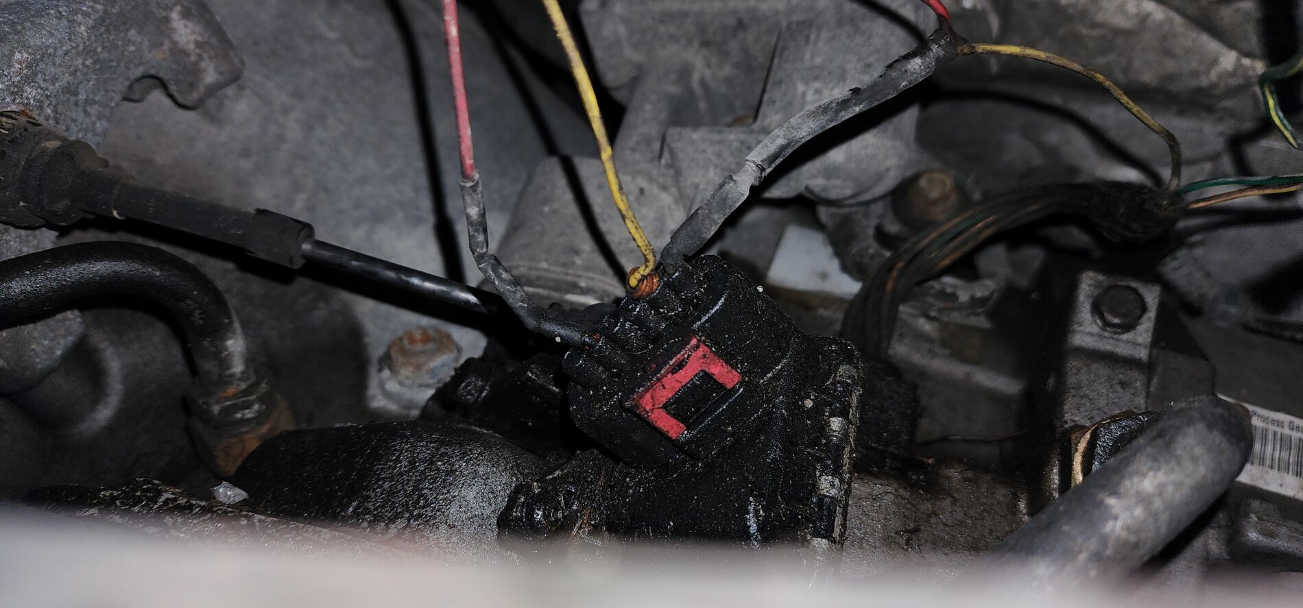

Can anyone tell me what these wires are, or what's up with then? They are near the plug on the drivers side of the trans. It appears that someone who owned it before me did something with the wiring, and I don't have a clue why, unless it's somehow related to the aftermarket alarm system, or the remote start that doesn't work correctly. Or perhaps it's related the slushbox feel for the trans under certain conditions... I don't know.
If anyone can help out with some info it'd be greatly appreciated.
Truck is a 2006 2500 mega cab, 4x4.
I can try to take better pics if anyone needs different views to see what's going on. I was in a bit of a hurry when I took these.
It's for P/N safety and Gear indicator on the dash.

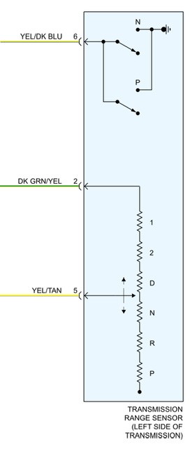

Someone here will provide you with the wiring scheme as all these wires go into that plug.

I'm sure someone will chime in and provide a diagram for your truck.
And from your pictures you might want to buy a pigtail for that as your connector looks pretty hacked.
Park/Neutral safety switch connector you are looking for, ebay or Amazon sells them.
Ozy, I’ve looked all over AllData for a connector diagram for the Range Finder Switch and this is all I can come up with.

I guess my primary question is... Will the way mine is wired currently, or the two non connected wires, (aside from being a tota hack job as far as the actual connections) have any negative effect on the way my trans operates?
Second question being, would the way its currently wired, or not wired (since there is two wires not connected at all) be the reason the remote start doesn't actually activate the starter?
Third question, why do I have 2 loose wires not accounted for on the diagram posted here?

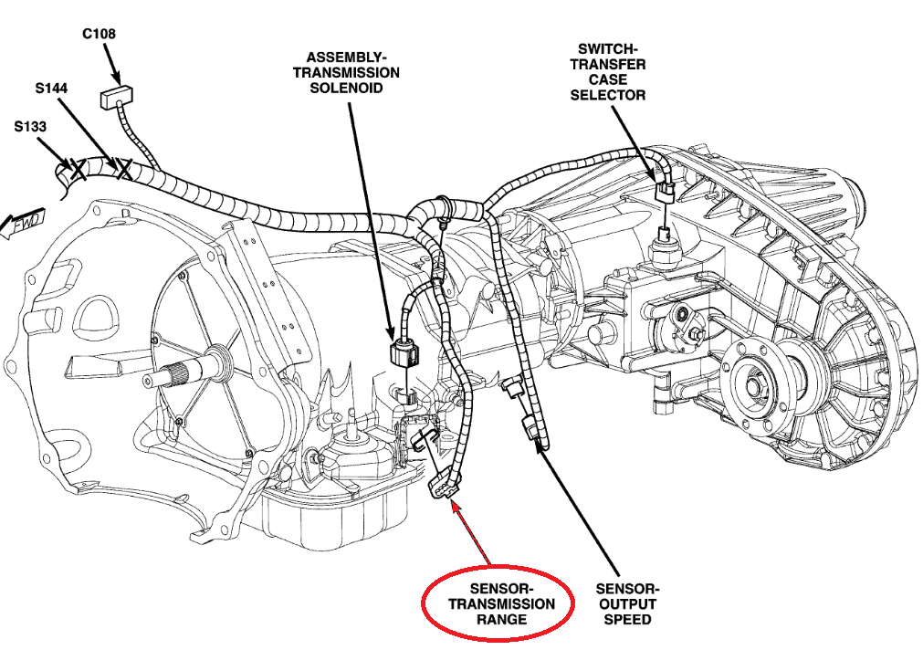

Just for clarity, we're talking about this connector, correct?
That Range Sensor doesn't have anything to do with how the transmission operates, it's for your PRNDL and so the ECM and PCM (and in your case, the alarm) "KNOW" what gear the transmission is in. I imagine your added wires are/were for the alarm and remote start. From what @Ozymandias said, the remote start can't be made to work on your truck but the PO ran those loose wires in an attempt to make it functional.
