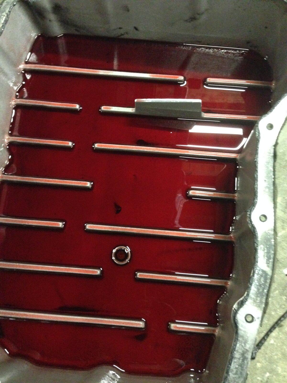

65k on truck with over 50k on AMZ/OIL using the MagHytec. This is a VERY clean pan!!!
Also 2/3 of those miles were towing HEAVY West Coast at 29K combined.
