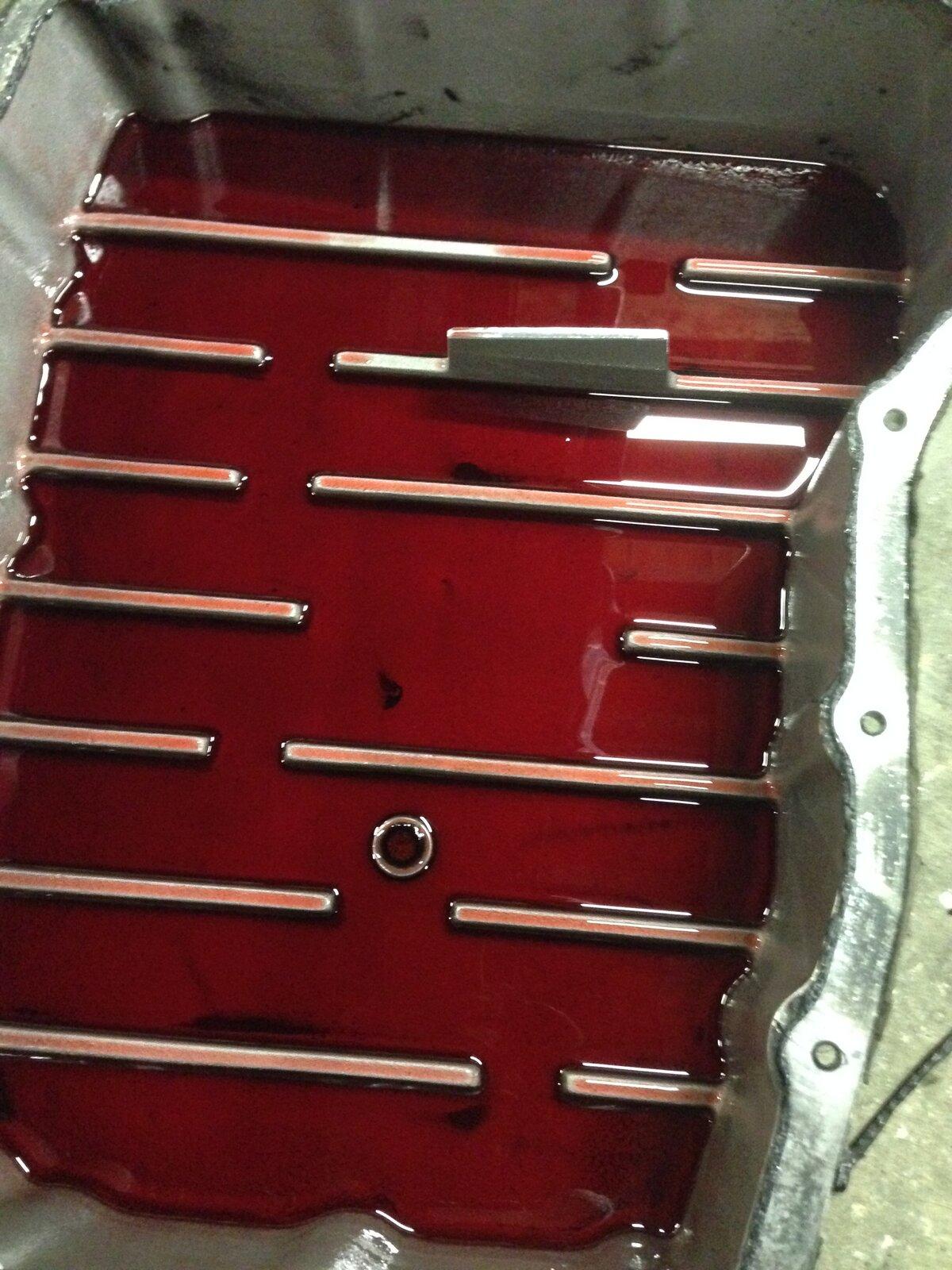

This is my pan at 65k. I completely changed the trans fluid at under 15k so at least 50k on this fluid (AMZ/OIL). Oh yea I was towing 29k combined 2/3 of those miles.
I just changed my transmission oil for the third time in the 68RFE, last week. My Mag-Hytec transmission pan looks just as clean as yours does with only draining the transmission oil from the pan and replacing the two filters. I do a partial oil change as per the O&M that the manufacture wrote. The fluid is changed between 50,000 and 60,000 miles.

Take a look in the FSM under fluid and filter replacement. There is no service procedure for anything other than drain and fill, aka partial fluid change. The refill procedure then differentiates on the fluid required for a fluid change vs an overhaul.
You can also look under fluid capacities and there are 2 quantities, service and overhaul. It's very obvious that Dodge/Ram/FCA only intend for a drain and fill for the "change automatic transmission fluid".
