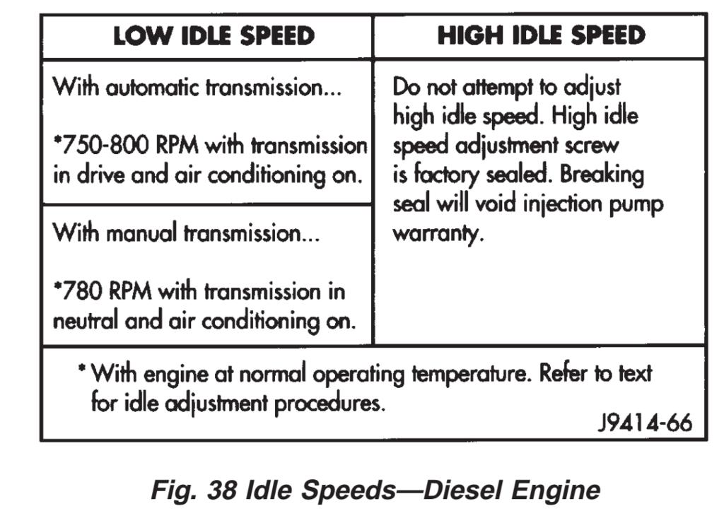

It is 750-800 for automatic on a 96 as well.
