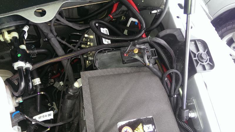

Shows where I placed the Stryker. No holes were drilled. I can remove module and harness W/O any evidence of anything installed in engine compartment
