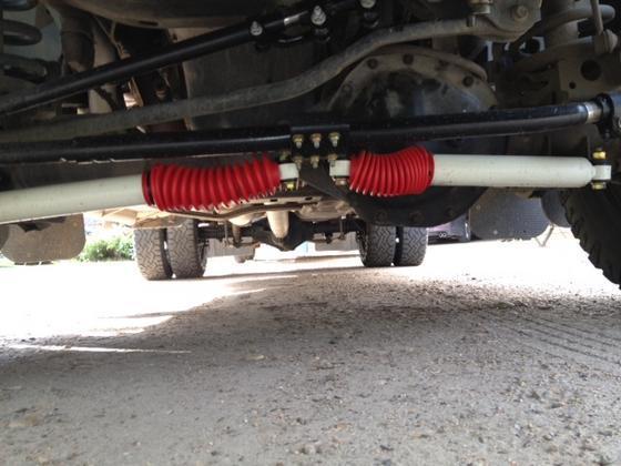

Upgraded steering linkage with Defiant dual steering stabilizers

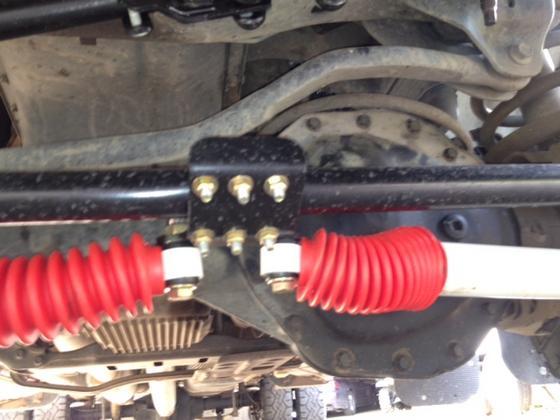

I have the Defiant dual setup on mine. I originally installed it with the stock steering linkage. When I installed the 08 upgrade linkage Paul Fox sent me the new brackets for a good price. I also did some R&D for him.

What did you modify to allow the stabilizer to fit without hitting the diff guard and differential cover on the driver's side?
Paul Fox gave me modified brackets designed to work with the steering upgrade. I don't remember specifics of the mounting change only that I tweeked it for a while till I was satisfied.
All that matters to me is I can drive with 100% security even with parts worn and never get a hint of DW. Bandaids are temporary... this isn't a bandaid. It's an addition piece of equipment that belongs, in my book.
