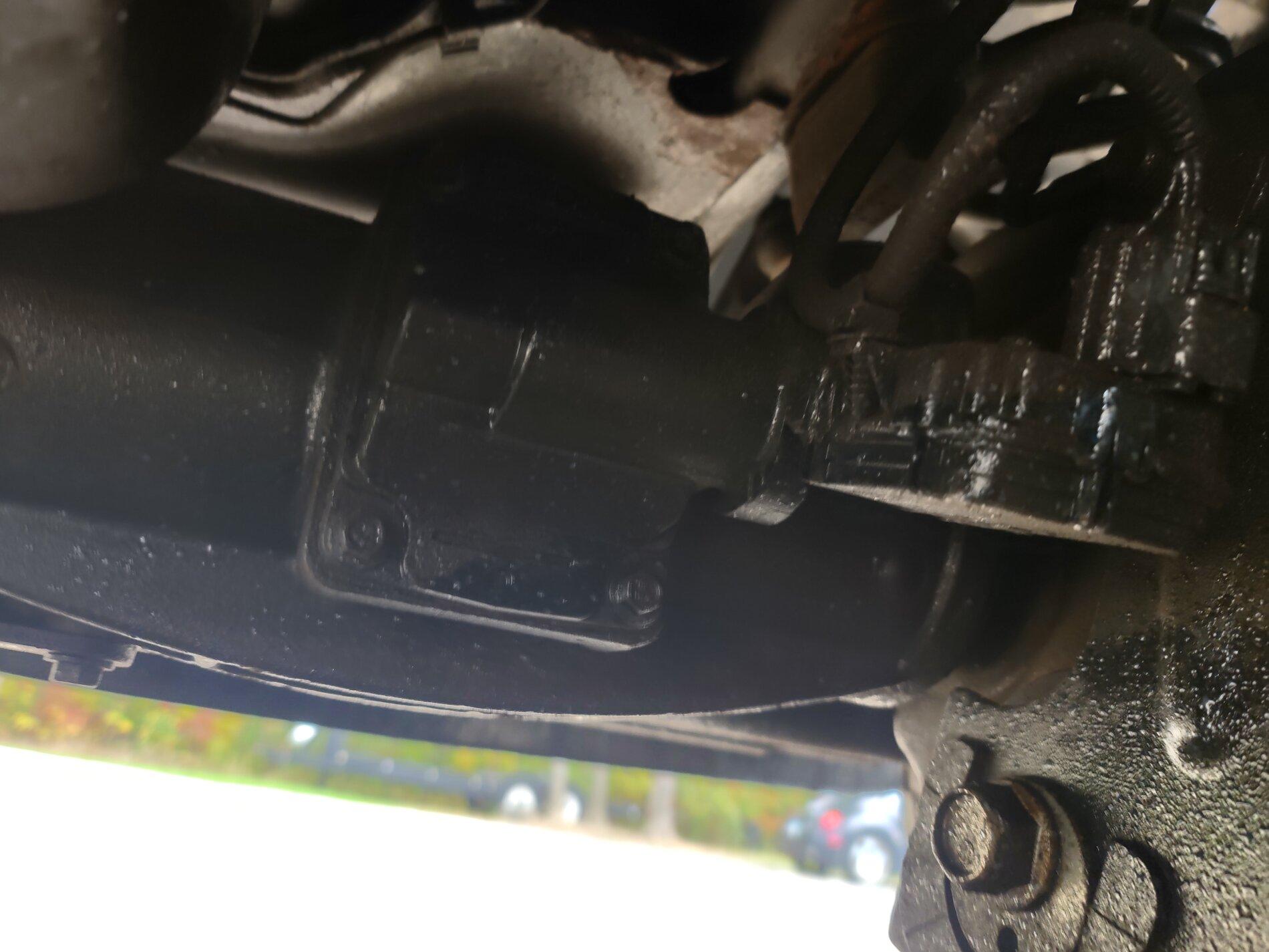

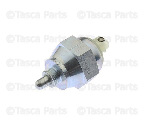

But on the manual cases there is a switch like this guy here on the top of the case
When shifted into 4wheel drive the lever activates this switch on top of the tcase and energizes the CAD, this guy on the front axle. (Sorry for poor pic)
The gen 2's worked in similar manner but the switch on top was vacuum actuated vs electrical, a vac line coming from the pump and a pair of lines going to the CAD on the front axle.
