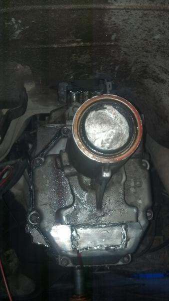

So I had a 2wd extension housing and I bolted in place of the broken 4wd housing filed trany full of oil and ran I through the gears again and the vibration was gone now so its Gota be the transfer case.
pic of 2wd extension housing
