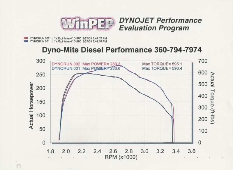

My 2001.5 dyno's low for the mods it had. Bill from DTT said it should have been higher. Later I learned about the throttle cable issue. If you lifted the throttle pedal and it went up more than a 1/4" or so, you were not getting full throttle. Solution was a split fishing sinker or tie wrap on the cable at the top of the pedal. Bill said I should have put down more like 325/650.
