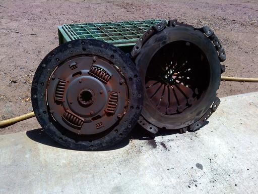

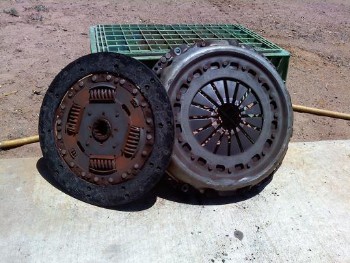

Yes, that is correct. The squeal started when the clutch was depressed. The bearing came apart, balls at the bottom of the bellhousing, which decreased the throw enough that the clutch could not disengage. I have the parts, and they were due to be changed. If I get a chance I shall post the pics. I really can't complain, thi struck hasn't cost me that much considering the mileage I have put on it since I bought it in 05 with 101,000 miles. 214,000 miles that I have put on it since then , and a lot of them with a trailer behind. 1 APPS sensor, brakes all around, water pump, lift pump, and a clutch. Oh, and the center link after running over a dead 1,200# steer on the road... . The power steering system will be next, starting to leak out of the gearbox.
