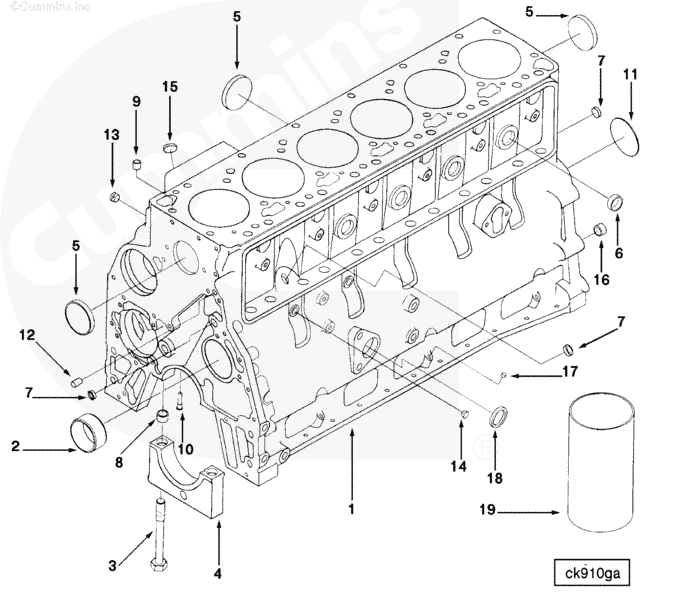

I'm on the run right now, but will post a block diagram that shows the freeze plugs tonight if that will help... .
Mike.
Here you go, I used the Engine Serial Number for my '97 which should be the same.

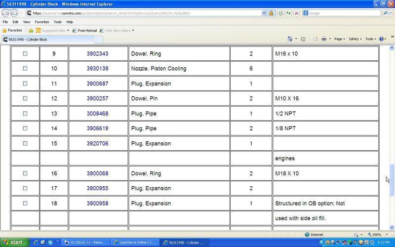

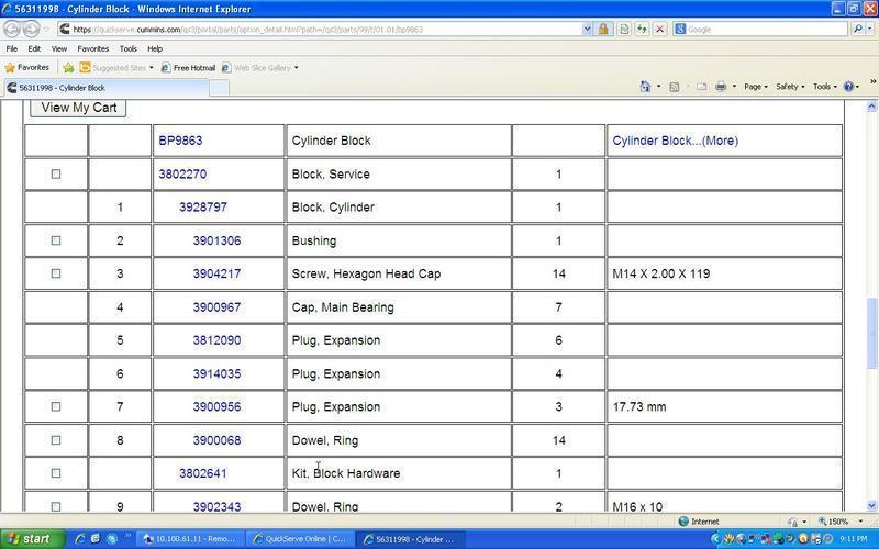

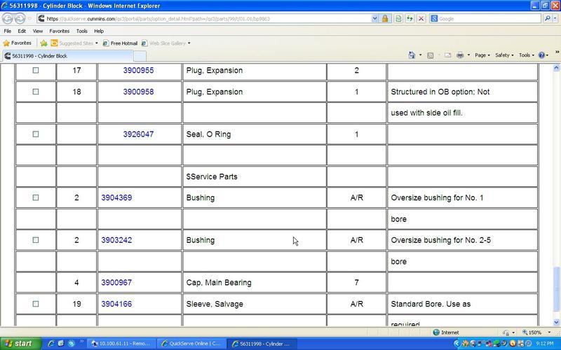

Here are the part numbers, key numbers, quantities and description to help you identify the freeze plugs.
The only way that I have found to do this is with screen shots so bear with me...
