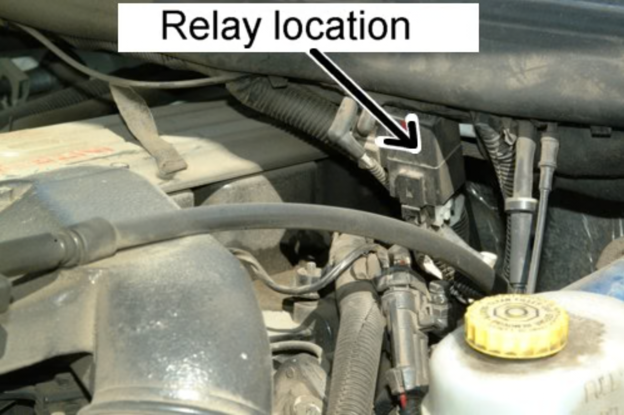

From Larry B’s website.
I just got confirmation on another forum from a member who has a '94 and a '97. They both work the same. Relay on the firewall, #9 fuse powers the hold circuit.
Update: I ordered, received, and installed the new shutoff solenoid and relay. I haven't gotten to the fusible link, and diode yet, but I will. I will be saving the additional relay that I bought, along with the solenoid I took off the truck for down the road.
The truck starts, shuts off, and restarts just like dodge intended. I am so thankful to have my workhorse back!
