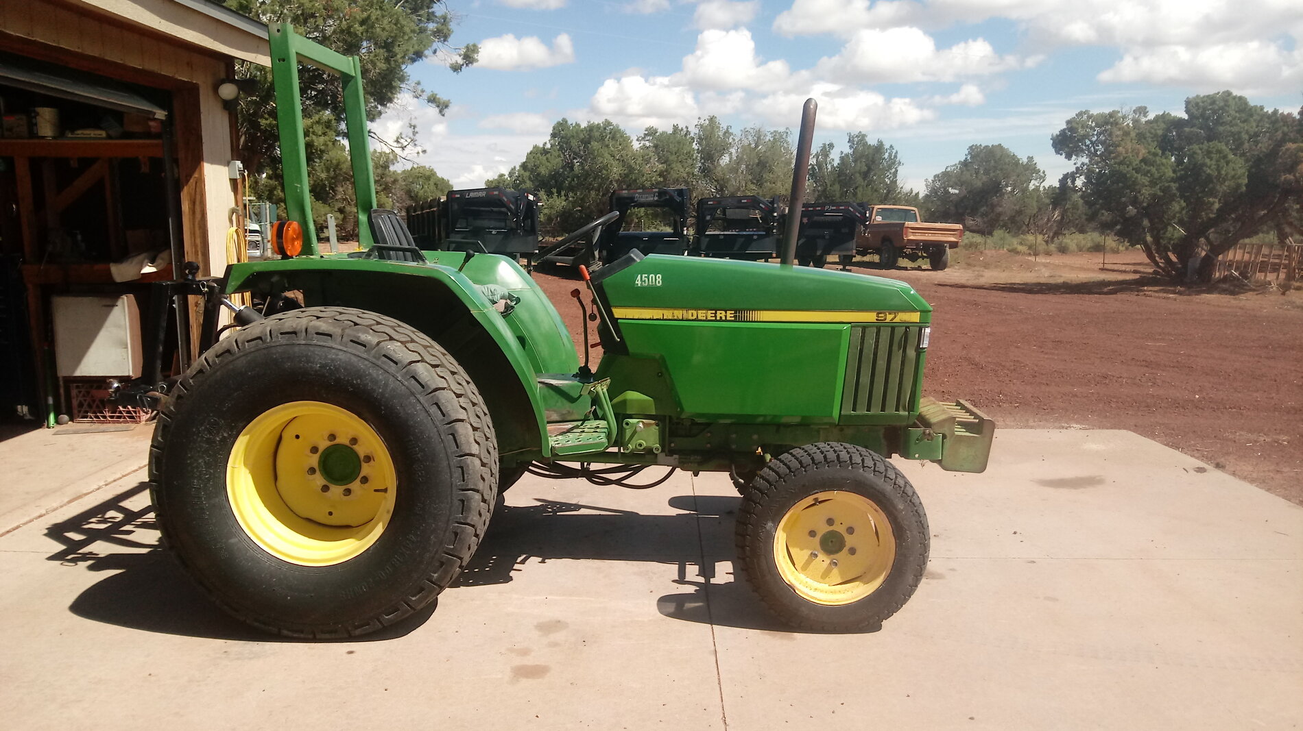

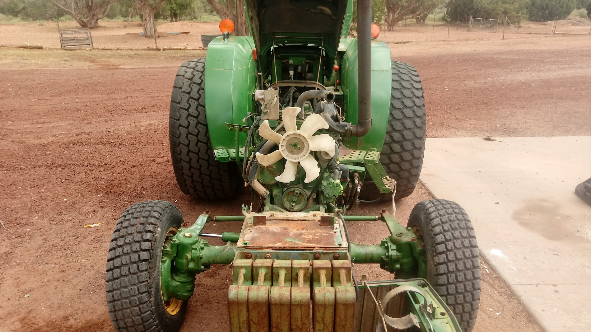

Told you I had a bushel basket of parts ordered:) Still need a few small items I overlooked and I want a canopy. I might go aftermarket or go oem for a newer model tractor. They are cheaper and more simple. The 970 oem is high dollar and fancy. Note the fan blades, with the right hand engine skirt missing the sun cooked it, the overflow bottle and the plastic fuel canister. They just crumble when you touch them. I need to run to Ace and get some JD green paint.

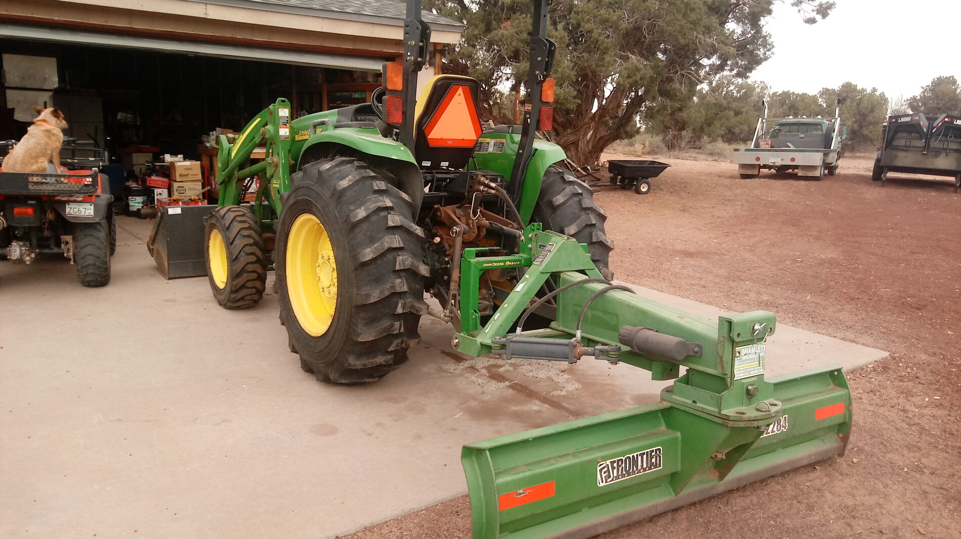

When you are a vehicleholic you are changing batteries or tires all the time:) The JD 970 got a group 31, 950 cca and the 4320 got a group 24, 800 cca. Bobcat loader, 3 new tires, 14:00 x 17.5 14 ply, one was fairly new. Front axle on the 4320, 10:00 x 16.5 10 ply. Rear, 17.5L x 24 12 ply are still on the freight truck somewhere. I did buy the Bobcat tires from the tire shop because I did not want to hand mount those stiff suckers. The tractor I am doing myself, the shop wanted $200 just for mounting plus quite a bit more for the tires. I can save $460 ordering and mounting myself, so it was no brainer. Won't be long and I will need to have them do it all:D
Finished up the tires. I went ahead and ordered them from the tire shop and paid to have them installed, money ($65 each) well spent I think. Carlisle Ground Force 600 R-4, 12 ply. The vendor that I ordered from wouldn't ship to a home residence. Tractor rent went up:D

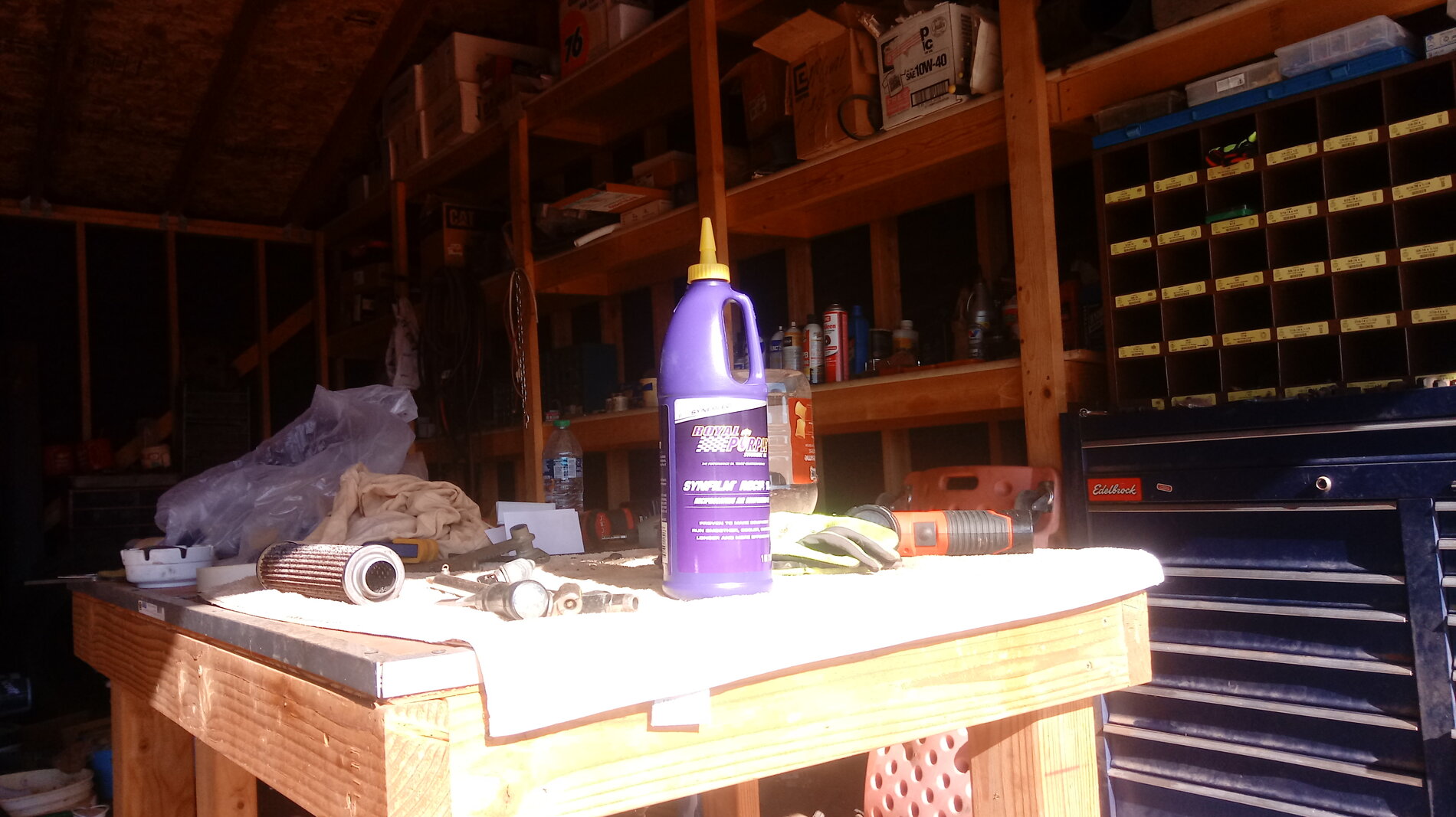

Changed oil in my shop air compressor and went with Royal Purple full synthetic. Good thing it only holds 1 pint and only change it once in a great while. $27 quart at Napa:eek: Standard oil was on sale at $3.59. It is 30 yrs old so I thought I would give it some love...

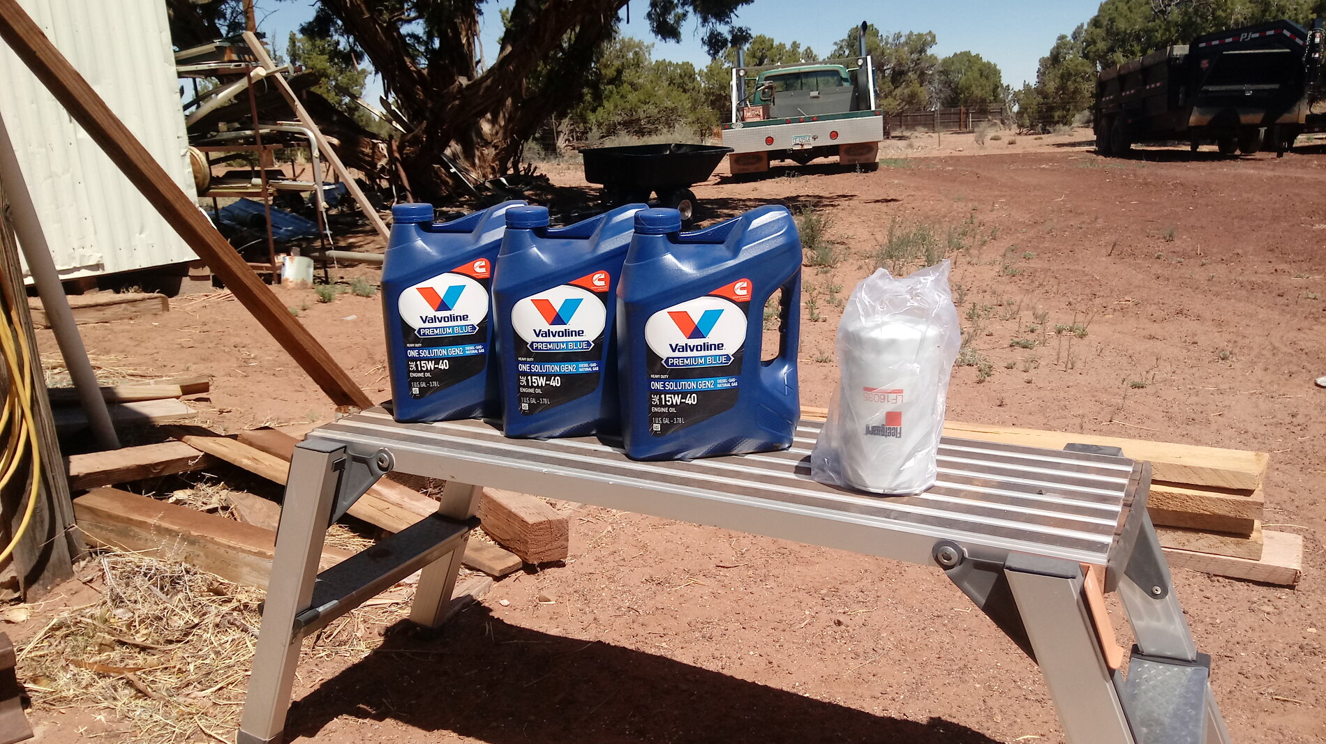

Changed oil and fuel filter in my '01 yesterday. Only 4k miles but 23 months so it was due. My new truck is also due, 11k miles but 11 months.

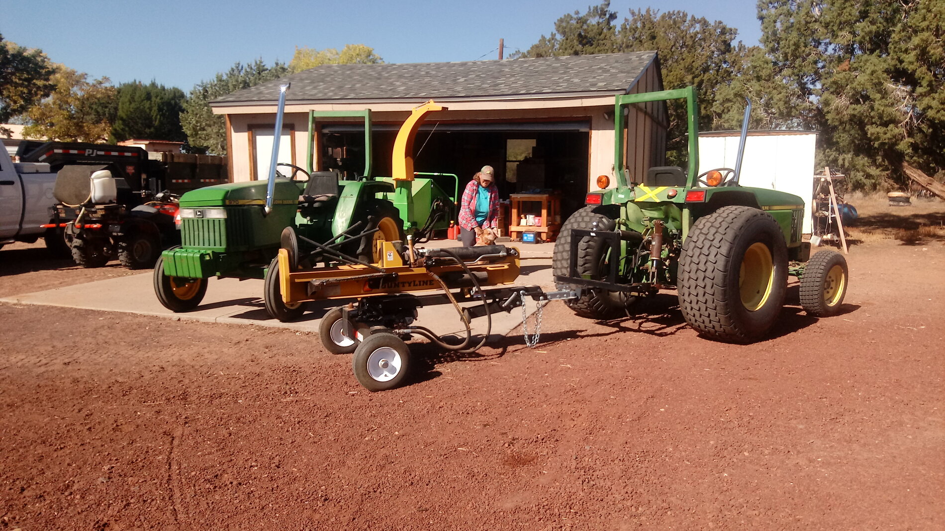

Welp, I modified the stop bar again:) I was told in the interest of safety, I needed to have stop, forward. Even tho I am one of those guys that have to stick my hand in a wringer washer to see what happens...I fixed it again...so now forward is stop. I reinstalled the bell crank which changes the throw of the valve. I did leave off the stupid handle.View attachment 121600
I recently did the bx102. Don’t understand the design on the stop bar. Like your modifications. Did you have to shorten PTO shaft? Have 5 different JD tractors all cat II 3 point hitches. All 18” from tip of PTO to center of draft arm ball. Guessing PTO needs shortened 8”. That was some big stuff guy put into this on you tube video.
Yes, the pto is cut to fit. That should be a dandy chipper. Do any of your tractors have 1000 rpm pto's? All my JD's are small, so only 540, but they still work fine. For high performance, the 1000 is better. I do have a Case/IH 995 with 1000 rpm pto but have never used it. It is my dedicated power unit for my tub grinder.
Keep an eye on your chipper knives. On mine, they used like, grade nothing bolts and they were all mostly stripped, which allowed material to get behind the knife. That forced them away from the flywheel and they would make contact with the flywheel housing. I changed them all out with high grade stainless steel from ACE.
I agree, the safety bar is problematic. The limbs are always hitting it and stopping the machine. I didn't like it at all. I understand, it is a requirement to sell the chipper in Germany. I guess they have a certain safety requirement.
Thanks for the reply. In my 68 years on this farm never saw equipment that could run both 540/1000 without a gear change. Hard to imagine that 434 lb. 37” flywheel spinning 1000 rpm. What could possibly go wrong.o_O All my JD’s have 540/1000 pto.Will definitely check those knife bolts. Now to shorten pto, chopsaw and rat tail file should do it. Will try to upload some images.
Since all your tractors are category 2 and 540/1000, that indicates they have lotsa power. If you don't need/want the 1000 rpm performance, you can throttle down and still pull the chipper. At 540, the chip blower is a little weak, depending how far you need to throw them. Do you have both pto shafts? I only have the 540 so that is another reason I have never tried the Case/IH. As we age and slow down, 540 works for us:D
