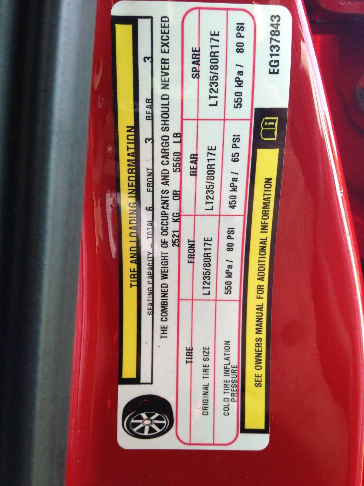

Look at your door sticker, unless you’ve added a HUGE amount of crap to your truck.
In this instance....my previous 2014 RAM 3500 Crew Cab 4WD weighed 8,440 lbs
(14,000-5,560) = 8,440

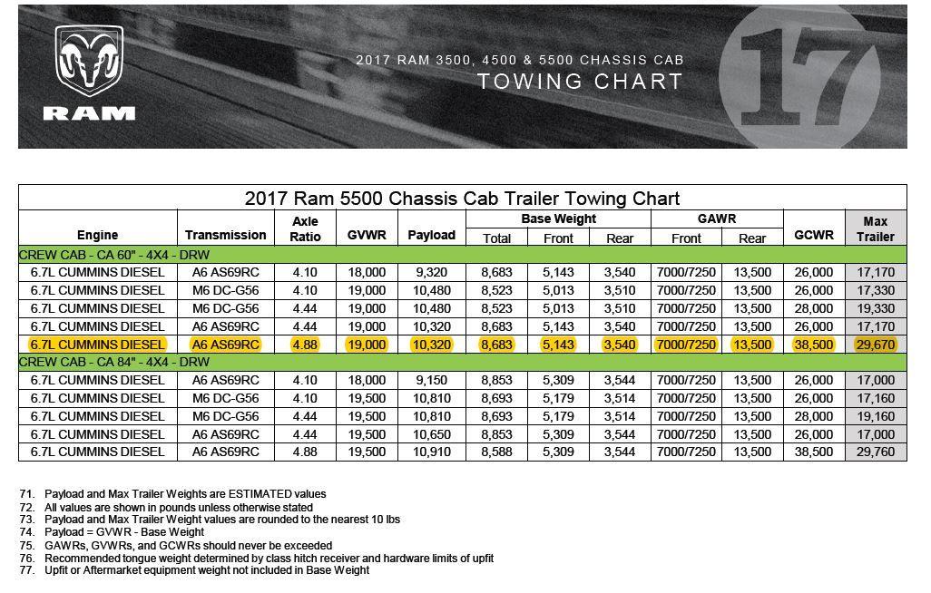

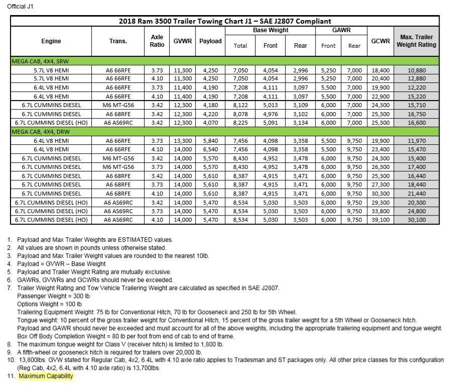

Earl, I think it's possible to get a good rough order of magnitude. That's why they ACTUALLY DO publish the base weights of the trucks. I pulled those charts from the Ram website.
I believe if you read the footnotes, you can get within 10 pounds of the actual base weight. How do I know that? They say they round to the next highest 10 lbs. That's why they break out by transmission, cab, bed length, etc... as these are biggest differences in weight.
FYI, I've been using these charts for years in deciding which truck would be my next tow beast.

Earl,
Look at my post with chart AND weight ticket. We're not saying different things so much. I use the chart to PICK my truck when LOOKING to buy, Then I configure it as I'm going to travel, load me, the wife, two dogs, 112 gallons diesel, 9 gallons DEF, ~600 lbs of tools, including two 12 ton jack stands, turnover ball hitch, stainless front grill brush guard. The bed the dealer added, soooooo on my 2017 Ram 5500 the following is pretty close. That's what you see on the weight ticket.
Base weight:
Front: 5,143lbs + Rear: 3,549 = 8,683
Weight as configured:
Front: 6,200lbs + Rear: 6,000lbs = 12,200lbs
I'm happy knowing my base numbers AND my loaded numbers.
Cheers, Ron

Base weights are published in the towing guide. There is even a options weight chart for addition or subtraction on the body builders guide.

With that being said.......and since Cliffman did not ask for EXACT weight, I thought the easy thing (prior to post #7) was to consult that door sticker. The door sticker reflects the weight of the truck as it was shipped from Saltillo by FCA.
