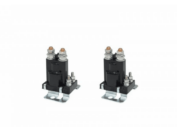

I think this is the relay used for your truck - don't know if one or two is used. You will leave the heavy wires intact. Each relay uses two small terminals - this is the coil portion of the relay. I believe one of the wires goes to ground and the other wire is supply voltage from the PCM. You will have to verify. If it is wired this way, you will need to install a fuse from a switched 12 volt source and route a wire to a momentary switch inside the cab. From the switch, run a wire to the small positive terminal of the relay. Make sure your momentary switch is positioned in a manner as to not being accidentally activated.

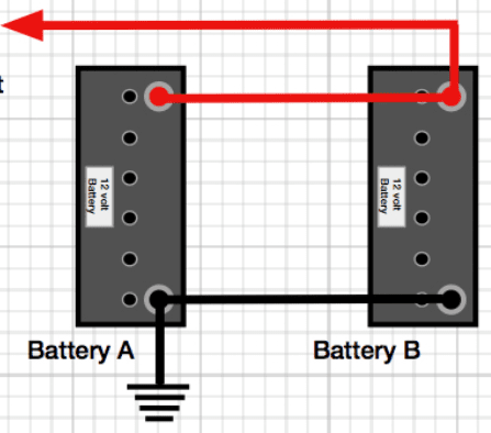

I've been thinking about getting dual batteries. Is it just a matter of hooking them up in parallel, or are there other modifications/parts I'd need? I've heard tell of people mounting dual batteries sideways in the stock tray. There appears to be plenty of room for 2 in there.

The coil of the relay doesn't draw much current. On the high side I would say no more than 1 amp each (more likely about half that). A 5 amp fuse / switch and 16 gauge wiring should work fine. You probably can't buy a switch with less than a 10 amp rating, which would be fine as well.

Cool, good to know. I don't think the first gens computer is that smart, so I should be fine. Gonna try dual batteries first, and if it still interferes with my gauges then I'll go the switch route. I figure a pair of 1,100 CCA batteries will get me straight.
