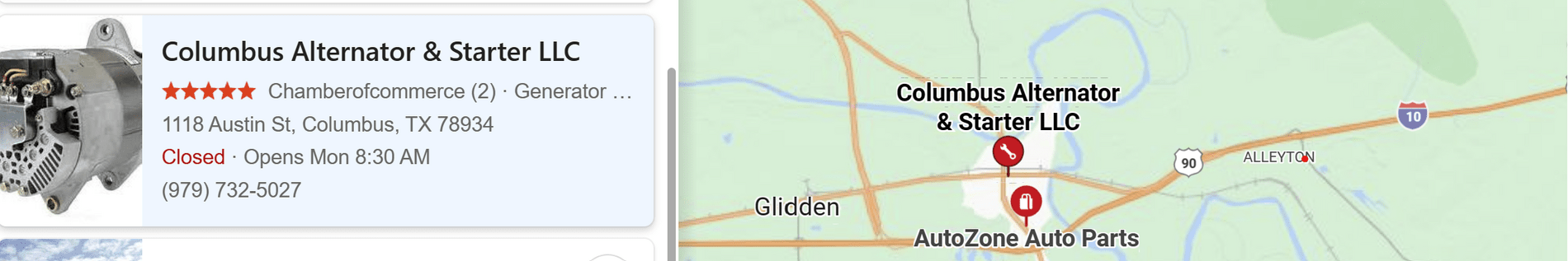

Not many alt./starter rebuilders anymore with O'Reilly on every corner. I'll look it up and see. Maybe in Houston.
Found this place on a web search. Anywhere near you?
