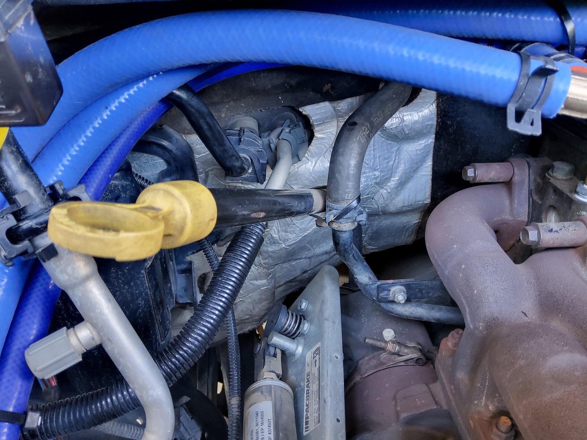

I think I know exactly what that is as I had it myself! Check the transmission dipstick in the engine bay. Mine made that sound due to it vibrating against the firewall or something. Started after I had the trans pulled to replace rear main seal. Can try bending it out a bit more, or do what I did, stick/wrap a piece of pipe insulation between the tube and the firewall. Stopped it.
Bent it just a bit to clear the firewall but not be closer to turbo. Worked like a dream. What pipe insulation did you use? Wondering what is safe to be that close to exhaust and turbo but not melt down
I am glad that worked! Soon as I heard your recording I knew exactly what it was! I just used standard pipe insulation from Home Depot. Far enough away from hot stuff that it doesn't melt (so far), and only enough to stop it from hitting the firewall.
nice!!! thank you sir. I was thinking of just using some 1/2” or 3/8” high temp fuel line and slide it over the top of the dipstick and then hose clamp it in place. But it was definitely that. There were specific areas on my drive to work where you could hear it turning left and after adjusting the dipstick didn’t happen and made the drive nice lol
Funny thing for me was I had solved the problem with the insulation, then had a new trans put in (and the dipstick was routed correctly) so no problem. Then I had my HVAC box redone (all new doors and actuators) and new heater core and AC bits (go big or go home!), and a few days later I got the sound again, but much softer (like the sound in your recording). I swore it came from the dash! (when you mentioned that I knew!) and took it back to the shop thinking they missed something in the dash when the put it back together, and when I picked it up they told me it was the dipstick again! DOH! Now I know....
yeah I was just recently quoted 3700$ to rebuild my ac box with doors, heater core and evap core. Trying to decide if I’m going to do it myself or not lol. I definitely am using blend doors USA for the doors and likely oreilly for the evap and heater core.
I say go for it. I cost me about that (used blend door usa doors) but what a difference it made! At the same time I had them remove the screen in the HVAC box (I have a first year megacab) and WOW the difference it made - now I have (for the first time ever) full flow from the panel vents. Should have done it years ago.
Copy thanks!!!!
I've mine fixed like this for years as it was always violently vibrating at idle.
