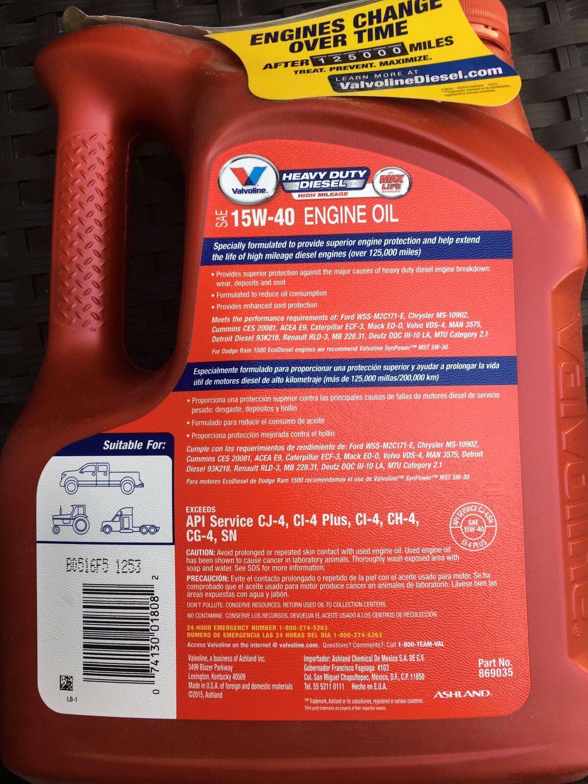

Been using this.
What’s important aside from the API rating is the Cummins rating of CES20081, which I believe is equivelant to CJ-4, not CK.
Its on the shelf at Walmart, and it wasn’t expensive.
That brings up another point. I was reading a Cummins Bulletin on engine oil for pre-DPF ISB’s and it stated that CK and CI oils were recommended, but CJ was only permitted. There was even a blurb stating that CK should be used anywhere CJ was originally spec’d
So it also appears that Cummins doesn’t like the CJ oil spec.
CES 20086 = CK
CES 20081 = CJ
CES 20078 = CI
Rotella exclusively from the first oil change. There are only 3 times a different oil has been in my truck. The first is the oil that was in the truck when I bought it. The second was when a Dodge dealer changed the oil by mistake when they were supposed to be doing something else. Not sure what they used. The only reason I knew they did it was because there was a Mopar oil filter on the truck, and I only use Fleetguard. The third was when the injectors were changed by the local Cummins Southern Plains shop. An solenoid O-ring failed and put diesel in the crankcase. The Cummins shop used Valvoline Premium Blue. Needless to say, I loves me some Rotella...
I never use that "high mileage" stuff in my engines because as I understand, it contains additives which cause the seals to swell which helps prevent leaking. Trouble is that it causes the seals to wear more rapidly and will allow easier leaking if that product isnt continually used. Again...thats how I understand the high mileage oils work.
Agreed- with “S” oil, but I believe this stuff is targeted towards older pre DPF engines, and if it carries the CES rating, it’s good by me.
All CJ oil’s meet the CES rating, but it’s not great oil.
As you can see in that bulletin I posted Cummins would rather you don’t run that oil you listed. “Permitted” is their way of saying it meets the specs, but we don’t think the specs are good.
