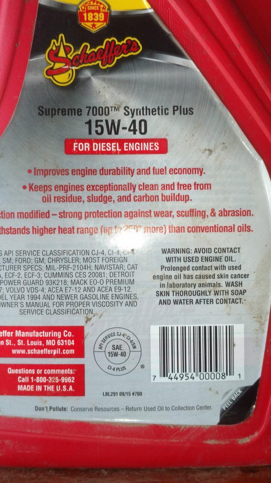

As to what I use in my engine, I’ve been running Schaffer Supreme 7000 for over 400K miles.
Just went out back and dug up an old jug.
Just in case.
Schaeffer's 7000 met the CJ4 spec until CK4 was rolled out.
At least I'm in good company :D
I didn’t say it wasn’t CJ. All I said was CJ wasn’t better than CI.
I get it from a friend that builds Yamah FJ1200 engines for the Legends race cars. He only use the Schaeffer Supreme 7000. He buys it by the pallet.
