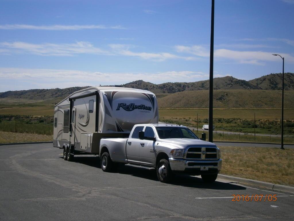

I drove one just like that the other day, it was impressive! However, it was only getting a little over 15mpg on the highway empty.
What kind of mileage should I expect while towing a 5th wheel?
Would a higher speed rear end be more economical or would it just not want to pull in 6th gear?

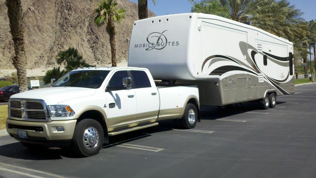

AISIN 3.42's!!! You will never be over 29k combined even towing the heaviest Mobile Suites. Benefit of 3.42's is you will save BIG $$$ on your return trip BobTail.
5th with 3.42's same rpm as 4.10's in 6th.
My comments are from owning both gear sets.
Don't get sucked into the 3.73 compromise theory.
Way too many variables to gauge mileage. where you drive, how you drive, what you pull, weather, etc. All things being equal, 12-13 mpg at max load is a good number. It will do that day after day with no issues if the electronic bugs don't bite.

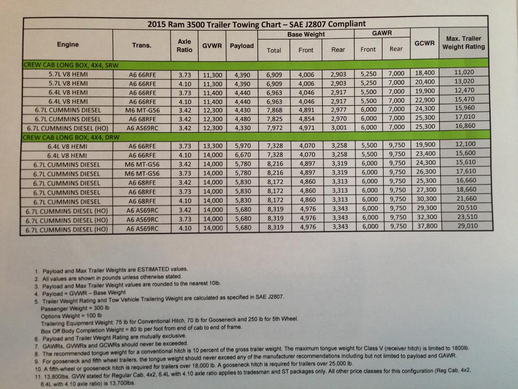

Give me a break! I towed this 28-29K combo for WELL over 1/2 of the 65K I owned the truck.
Like I said he will never exceed the FACTORY rating hauling even the heaviest DRV with 3.42's. It's all about making money and he will get the EXACT same mileage with the 3.42's as 4.10's hauling. BUT will save BIG $$$ when running BobTail.
To prove I am not talking out my AZZ here is the SAE towing chart for the 15's and the 18-19's will be even higher.
"Do you feel like the gods of physics kills a kitten every time someone buys 3.73's? "
YES!
Like I showed above RAM does know what they are talking about.
To the "you should be able to run all the gears" people. Do Semi's run in top gear when loaded??? I'm thinking they have other gear or gears for running unoaded for mileage.
I towed 29K West Coast for many miles got 9.5 mpg HAND calc AVERAGE. ONLY issue was not having the lower starting gears that the AISIN gives you. Just look at the chart. Remember this not what RAM says it's backed by the SAE J2807 test.
If the OP knows for a fACT he is going to exceed the 29K or so combined weight he should get the 4.10's.
Towing your own personal rig is not the same as hauling commercial. The very short time I hauled for a Broker, required me to have a pintle hitch rated at 20K or more, because they had a contract to pull construction silo's. And they were spposed to be empty, but were not always. You will regret the 3:42 when you hitch up to something heavy. I regret my 3:73 for just this very reason, although mine is a G56, when hauling at slow speeds in Commifornia. DRW 3500 HO, Aisin and 4:10's have a perfect combination for MPG towing and running empty. If you compare that to the 5500 with 4:88 that pull easy, but scream when empty or a 3500 with 3:42 that get better MPG, but will lug when heavy (oh BTW, give you poorer mpg heavy because its like pulling uphill most of the time), so the 4:10's are your best scenario.
