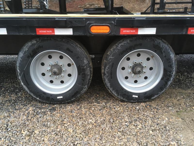

Gatormade makes a 20k gvw with 8k axles and 17.5" wheels. I can't tell from the pic if they are 16" wheels or 17.5's, if they are 16" wheels then your probably right. 7k axles /16k gvw. Either way it's a nice rig.

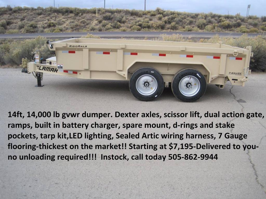

Opps, my bad, I didn't even consider that. However, the wheels appear to be mod style, the 17.5's are usually solid, like these.
Nick
Here's a shot of the 17.5"s Gatormade uses, they look a touch different from your dump.
That being said I'm on my phone this morning so can't get a good close up of Greg's picture. So you could very well be right... again :)
