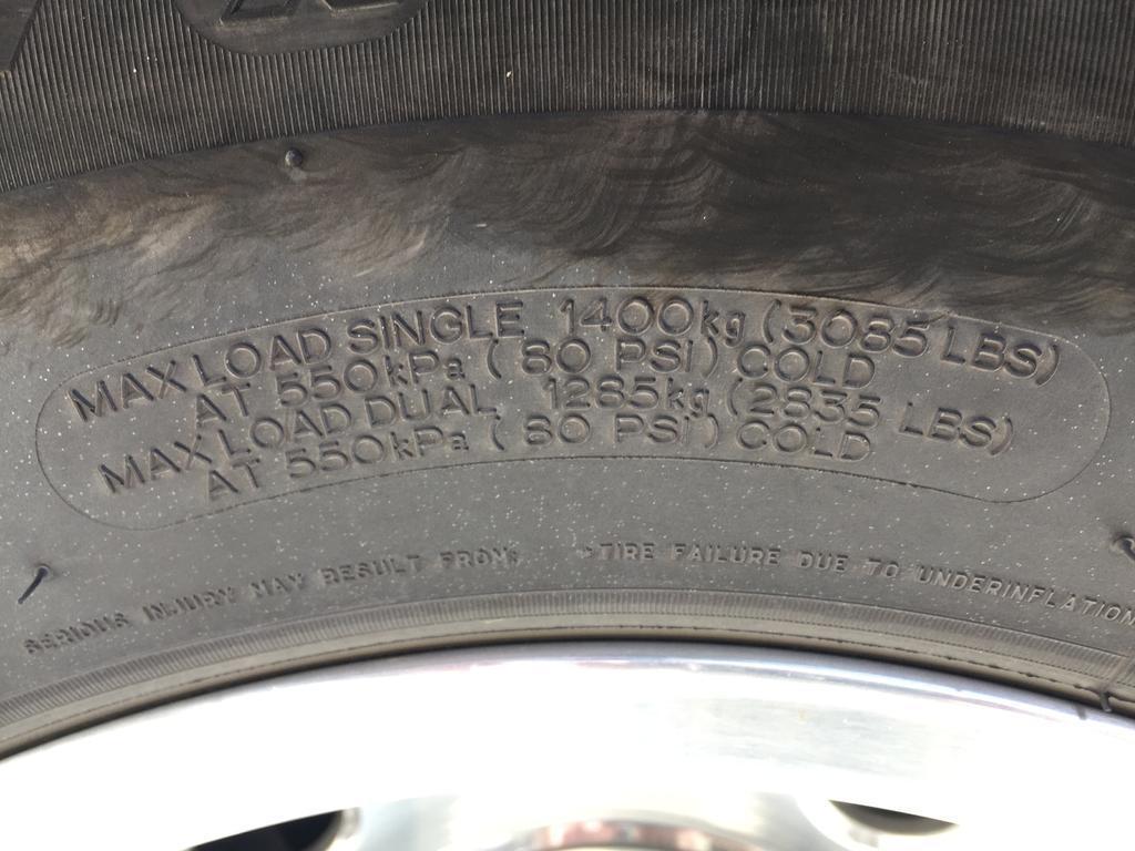

back to the question.. DRW is for the PIN Weight. the larger the trailer the heavier the pin pushing the tow vehicle over its GVWR... The 4:10 pulls better.. the auto level levels the truck... Its not that hard.. No over thinking required...4 rear tires have twice the carrying capacity of two..
The capabilities of optional DRW are clear. However new unloaded RV's don't require DRW to remain within the ratings. Maybe if you run across a loaded "bunkhouse" for a carnival you may need DRW. Even if a new RV is too heavy for SRW you can still turn it down and ask for a lighter trailer to haul. So consider the extra purchase price expense, 2 extra tires wearing out, and the fact that you are not getting paid for the extra capacity of DRW. Yes, NOT PAID FOR DRW: The towing requirements of the lease we had with the RV broker were within the SRW's abilities and we could go back on the broker for dispatching us to tow more than the lease stated. It hurt less going to the tire store for new tires 2x that year. If you want the best tires skip the LT's and go for longer lasting commercial 19.5" tires where one tire can carry more than a dual configuration of LT's. Hauling slide in RV truck campers would change the equation. Hot Shot is the wildcard where DRW make sense if not just jumping to a 5500 with 19.5" rubber on it from the word go.

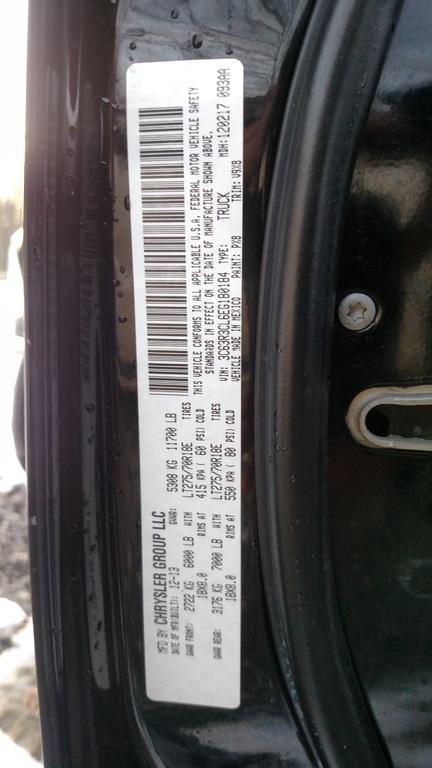

I think it was the Tradesman that has 17" rims and all the higher models had 18 or 20" RIMs. I do not believe that 16 rims have cleared the calipers many years.
Door jamb sticker on my Tradesman
16" wheels went by the way side along with the gen 2. Sure would be nice to be able to keep the convo relevant rather than continuously have to correct the same individuals on misinformation they spread.
