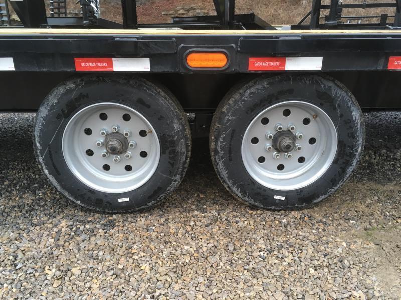

Here's a shot of the 17.5"s Gatormade uses, they look a touch different from your dump.
That being said I'm on my phone this morning so can't get a good close up of Greg's picture. So you could very well be right... again :)
Note the marker/signal light with the support plate, that is a good idea but not the spliced rub rail at that location. My sons Big Tex has a slight bow right in the light on his side rails. A surface mount would be better, here. Not nit picking Gatormade..... well maybe I did :)
