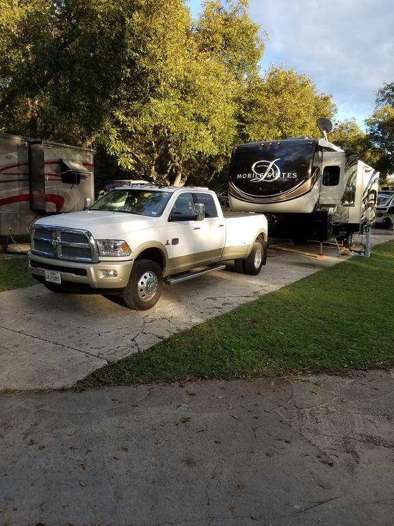

3500 DRW, Aisin AS69RC transmission and 4.10 axle ratio. Our 2016 Ram Longhorn crew cab long bed 3500 dually 4x4 so equipped is rated for 30,050# trailer tow and 39,100# GCWR. We tow a 19,000# GVWR DRV Mobile Suites 38RSSA, but the larger DRVs can have GVWRs of 23,000# or more. If you're going to be oilfield hot shotting, you'd better be equipped to handle some significant loads on a gooseneck!
The RV was hauled to Rolling Retreats in Elk City, OK the Dealer I ordered it from. They did the PDI then shipped it to NW WA. The truck was HDT that hauled it both places.
I was at the DRV Factory and watched several new RV's leave some as heavy as mine and heavier by 3500 DRW trucks.

3500 DRW, Aisin AS69RC transmission and 4.10 axle ratio. Our 2016 Ram Longhorn crew cab long bed 3500 dually 4x4 so equipped is rated for 30,050# trailer tow and 39,100# GCWR. We tow a 19,000# GVWR DRV Mobile Suites 38RSSA, but the larger DRVs can have GVWRs of 23,000# or more. If you're going to be oilfield hot shotting, you'd better be equipped to handle some significant loads on a gooseneck! View attachment 101579
DANG Rusty that's a good looking truck! :rolleyes:
