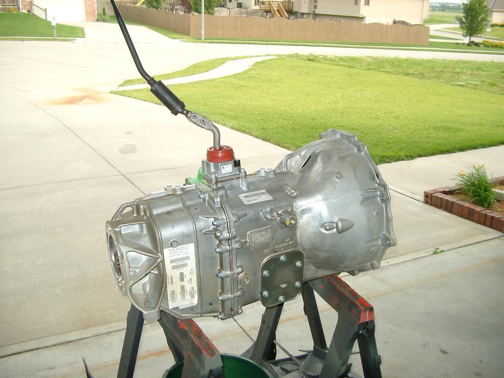

Picked up the transimission last nightOo. Getting ready to drain the fluid and pull the PTO covers so I can inspect it a little. Thanks to GAmes I will also be able to get the crossmember modified this weekend as well!
:cool:

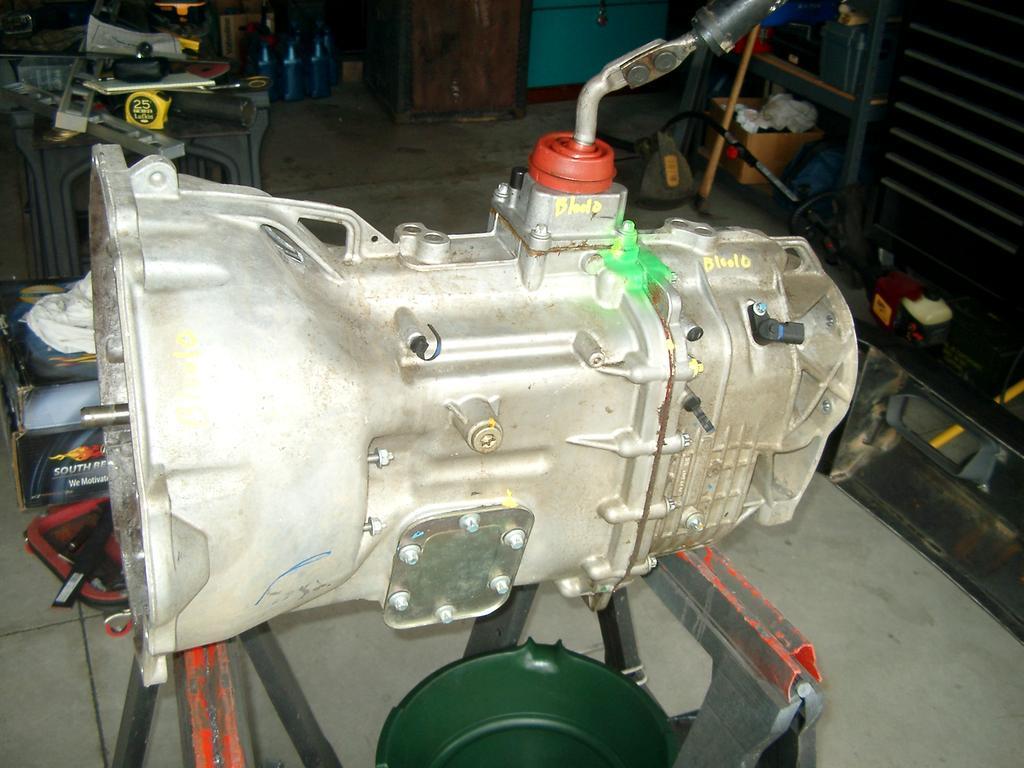

Pulled the PTO covers off and the Shift tower... Looks like new inside. As well as it should with only 28,000 on it.

Can anyone confirm if the mount is the same as the NV4500? My tape measure certainly thinks it will fit. Also, are the bolts into the bottom of the transmission the same?? If I have to find bolts I'd rather do it now rather than with the transmission up in the air on a jack:-laf

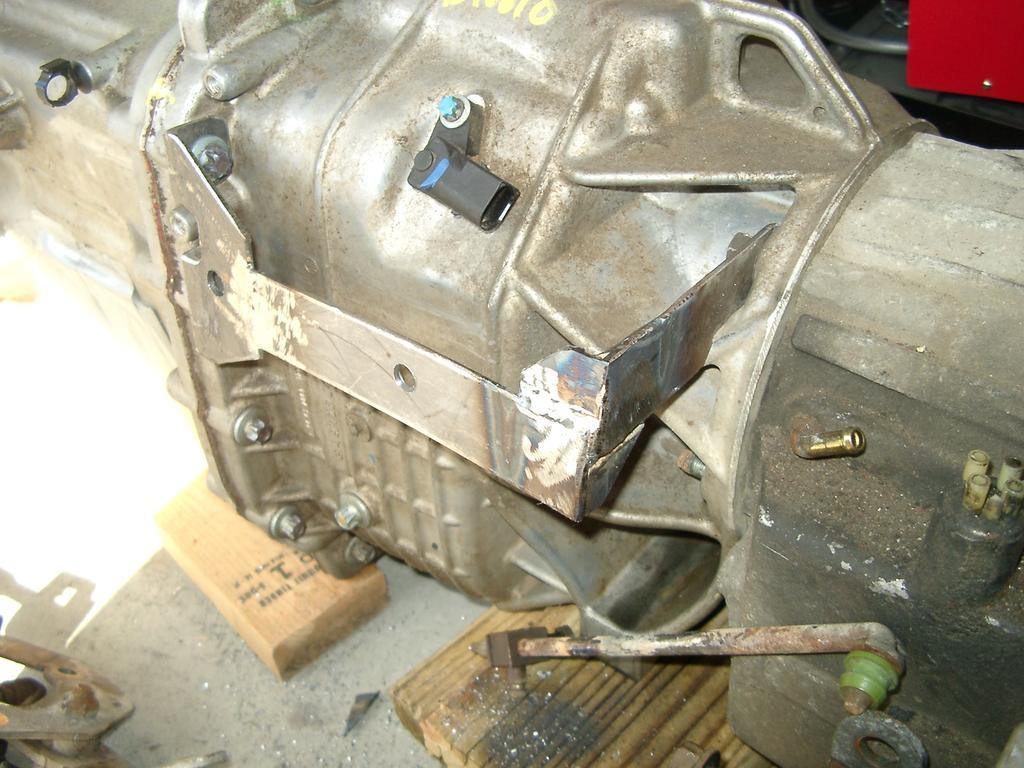

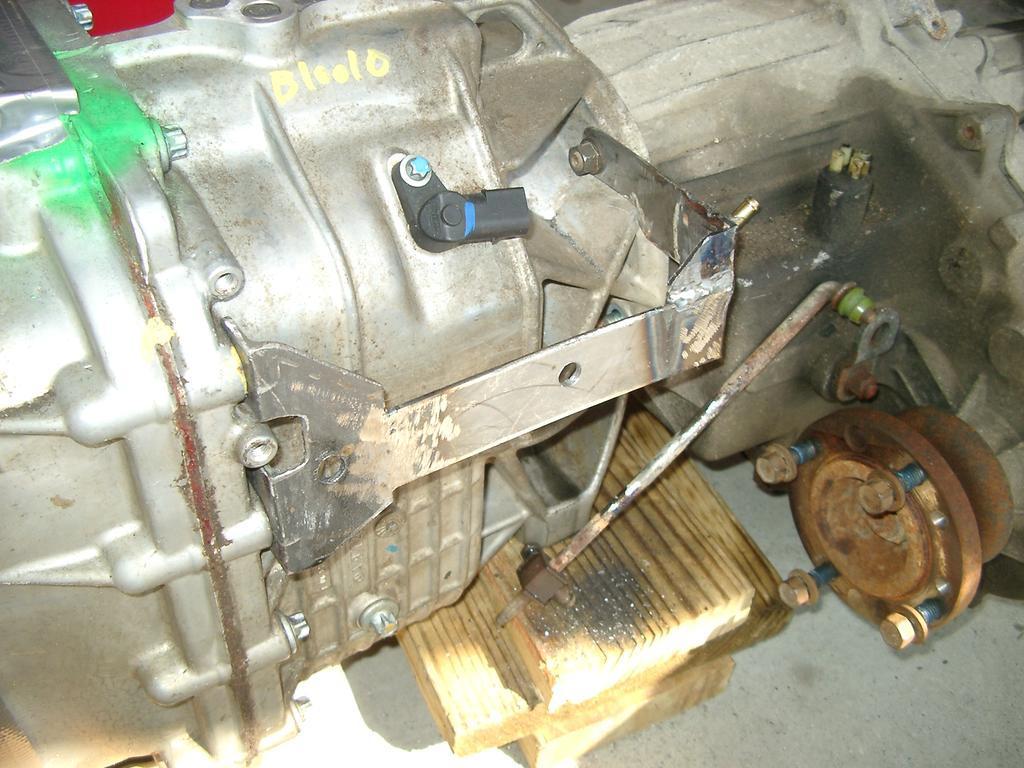

The stock mount fits, without the adapter. I used the bolts from the old transmission. I cut the exhaust pipe support off the adapter, bolted it to the crossmember and rewelded the bar to the pipe. I think you can see it on this pic, but will take a closer one if you need it.
That's great, I hoped that the old bolts would work. I was thinking about trimming the exhaust mount off of the adapter and use it under the bolt on that side, like a washer... But I think your method might work better with my oversized exhaust.

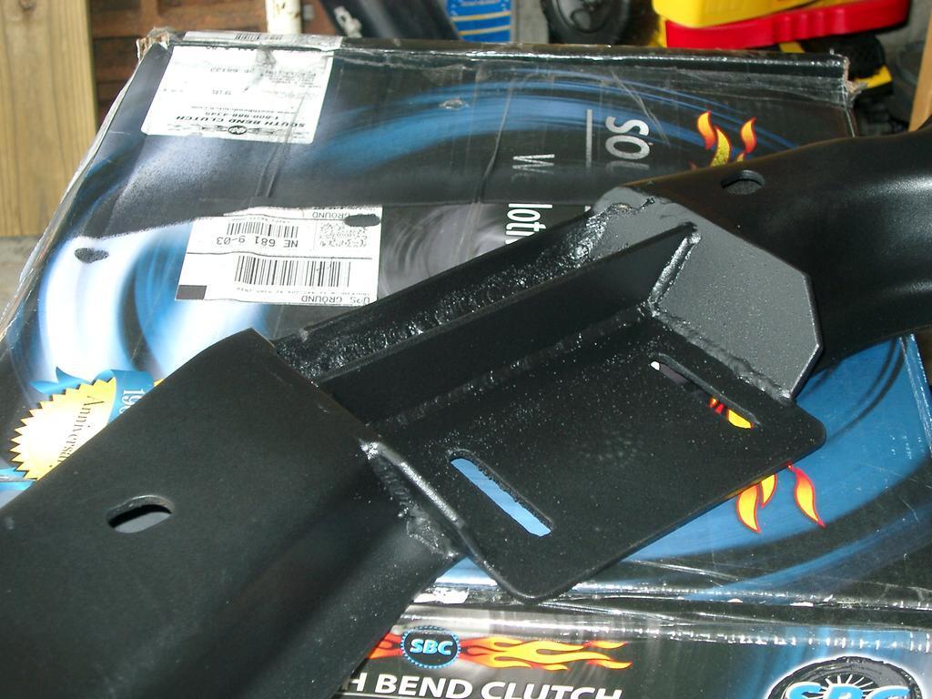

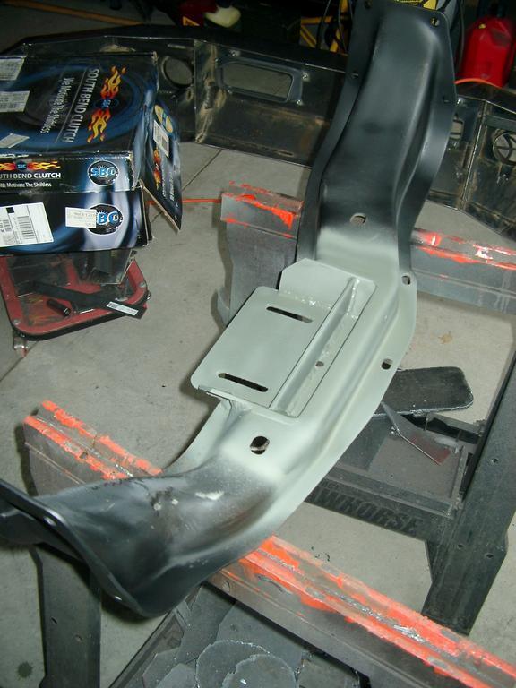

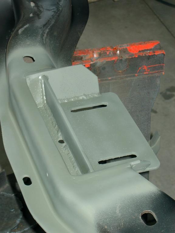

Crossmember modifications are complete!
Mark, I hate to tell you this, but there is a reason that Eric and I cut the entire raised portion of the mount. The front of yours will more than likely hit the bottom of the G56:{
I have already discovered just that:eek: I definately out thought myself this time. Initially with all of my measurements I thought it would clear and had thought about just boxing the whole thing but figured I'd wait for a test fit. But yes, as I studied your pictures more carefully I figured I'd better head out to the garage and rig up a little test fit. It did fit but only with the crossmember slid all the way back. So... . I just got done doing a little trimming to ensure I have plenty of latitude when it comes time to install;)
No worries. Better to discover it now vice when I am wrestling to install it.

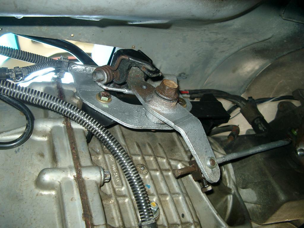

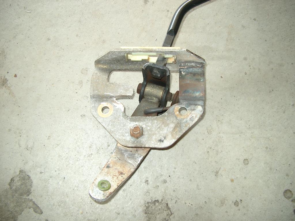

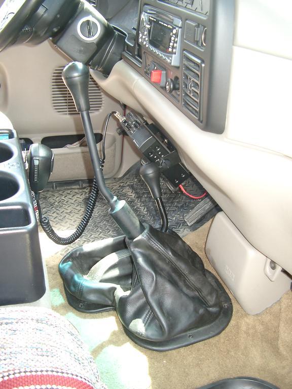

Just finished the 4wd shifter and linkage. It turned out to be a little more involved that I had first thought:rolleyes: After building a bracket and extending the linkage, I then had to bend the bottom portion of the shifter inboard to clear the front driveline. Not sure if retrofitting an 09' shifter would have been easier as I have never seen one, but I have a little over a day just wrapped up in the shifter & linkage between figuring and fabricating:D

Went for a test drive before dinner... Smooth as silkOo. It was suprisingly easy... Almost like it came from the factory with it. Still have to button up the interior. I'll post some more pics tomorrow.
Project officially complete now!
Had to rework the 4WD shifter today. Discovered I couldn't get into Reverse or 2nd when in 4Low. Glad to find that out now vice later:)
