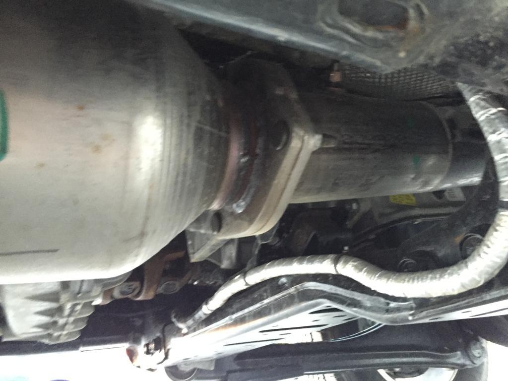

Yesterday, we left for Ventura to visit the mission for my daughters 4th grade project. I stop at a fuel station about 12 miles down the mountain from our house. I leave the truck idling while I'm filling. When I first got out, I smelt something funny and I can hear a new ticking noise directly under the cab. Then I had a visual, white smoke boiling off the exhaust. It was hard to pin point if it was coming from the flange or the pipe in front of the flange; too much smoke to see. At this point, I have 731 miles on the odometer.
I shut the truck down, and finished my fill. On startup, no codes appeared and no smoke from the exhaust for the few minutes of idling. We continued on our short trip to Ventura.
Any ideas what happened?
In my uneducated opinion you just experienced you first DPF regeneration. The smoke you saw was the exhaust pipe getting the hottest it's ever been since it was assembled, burning off oils and such. You said you have 731 miles. Well I have been monitoring my regenerations and with my driving style my truck regenerates about every 600 to 800 miles. My first regen I could smell burning rubber and other smokey smells also. If I am correct your next regen will not be near as smokey and the third will probably be un noticeable.
Sounds like a good theory, its typical for a furnace's first burn to smoke out the residence from the oils due to manufacturing. I also experianced the odd smells when my 2014 was new. Didn't see any smoke or ticking, but I did't look either. The ticking was probably the expansion of metal from the excessive heat of regeneration for the first time as well.
