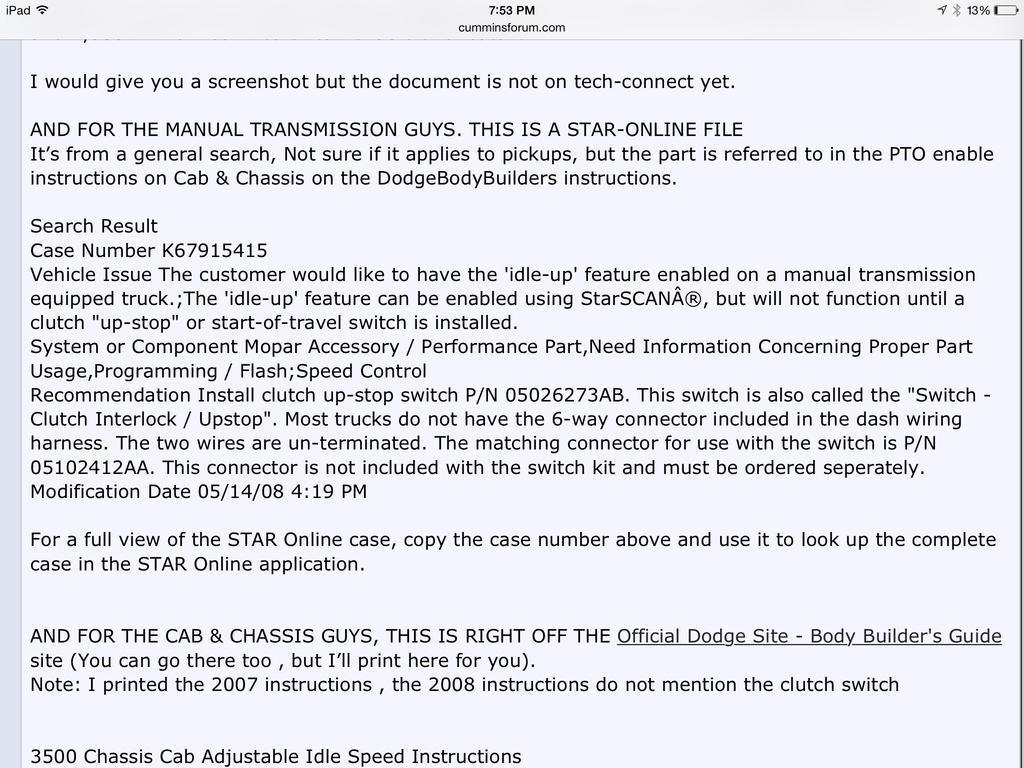

Read this thread it gives part numbers and procedures for manual equipped trucks.
http://www.cumminsforum.com/forum/0...in/139395-my-dealer-cant-enable-pto-idle.html
Also here is a screen shot of the post that maters the most in the linked thread.
