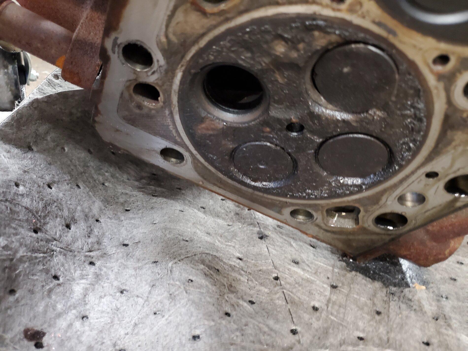

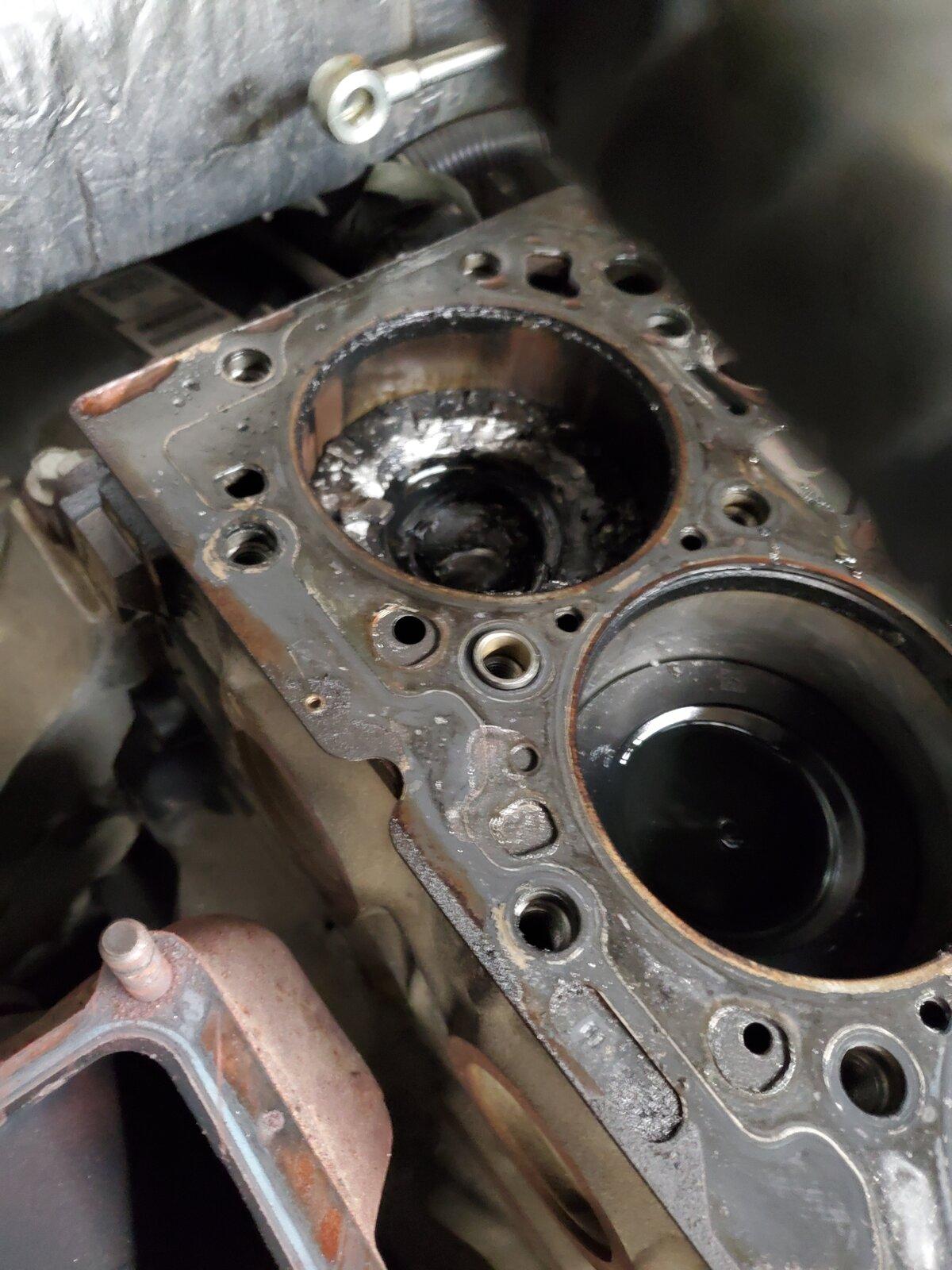

Long story short, the "broken valve spring" I was talking about in another thread was tip of the iceberg. #6 piston and cylinder just hammered. No idea what led to the broken spring but mechanic was speculating about "hydrolock", not sure exactly what that means or what the cause would be. It's a 2014 with 78,000 miles and it blew up driving down the freeway. Not really grenaded, just sounded like driving over expansion joints for a minute along with loss of power. Immediately pulled off, fortunately it happened right at an exit. Got towed to the Lithia dealership in Eugene, huge shout out to those guys, best service writer and service manager of any dealership I have worked with. That part of it could not be better. The MaxCare warranty experience was great for the tow, but after that not so good. I am open to upgrading my opinion of them as it goes along, but for now my question for the more engineering oriented people on the forum is this: who are these 3rd party FCA "inspectors" and what are their qualifications. Should they recommend a "long block" over a complete remanufactured Cummins engine, what would they base this on? Are they qualified to determine that none of the components to be re-used on a long block would not have been the CAUSE of the failure to begin with? I mean once the head was pulled the other 3 valves were hammered, probably the valve seat fell out and rattled around for a minute and piston and cylinder wall just wrecked. I can't attach pics due to super slow internet where we are currently, but will try again later.
I have tried to be a reasonable customer and I am not that mad about having it blow up because I understand its not a perfect world and stuff happens. But this truck has never had any mods, always maintained exactly by the book by DEALER (just had fuel filter done recently, ahead of schedule since we had a big trip planned), and always cooled down before shut off, never idled a long time, really driven by the book. Usually we are towing a 5th wheel so it could have been way worse, but still, out of town catastrophic failure is a bad thing especially at such low mileage. Is there anything adverse that could possibly result secondary to fuel filter change? That was the most recent service, along with oil change.

IMO the broken valve spring was the cause. The valve would have been hammering the piston until something else broke. Depending on where the spring broke it could have run awhile or broke the valve quickly. A dropped valve seat doesn't break a spring so the broken spring was first.
The long block is replacing most of the damaged parts. As noted debris could have hurt the exhaust side of the turbo. A good tech will check the intake and exhaust for remaining debris before bolting in a reman engine.

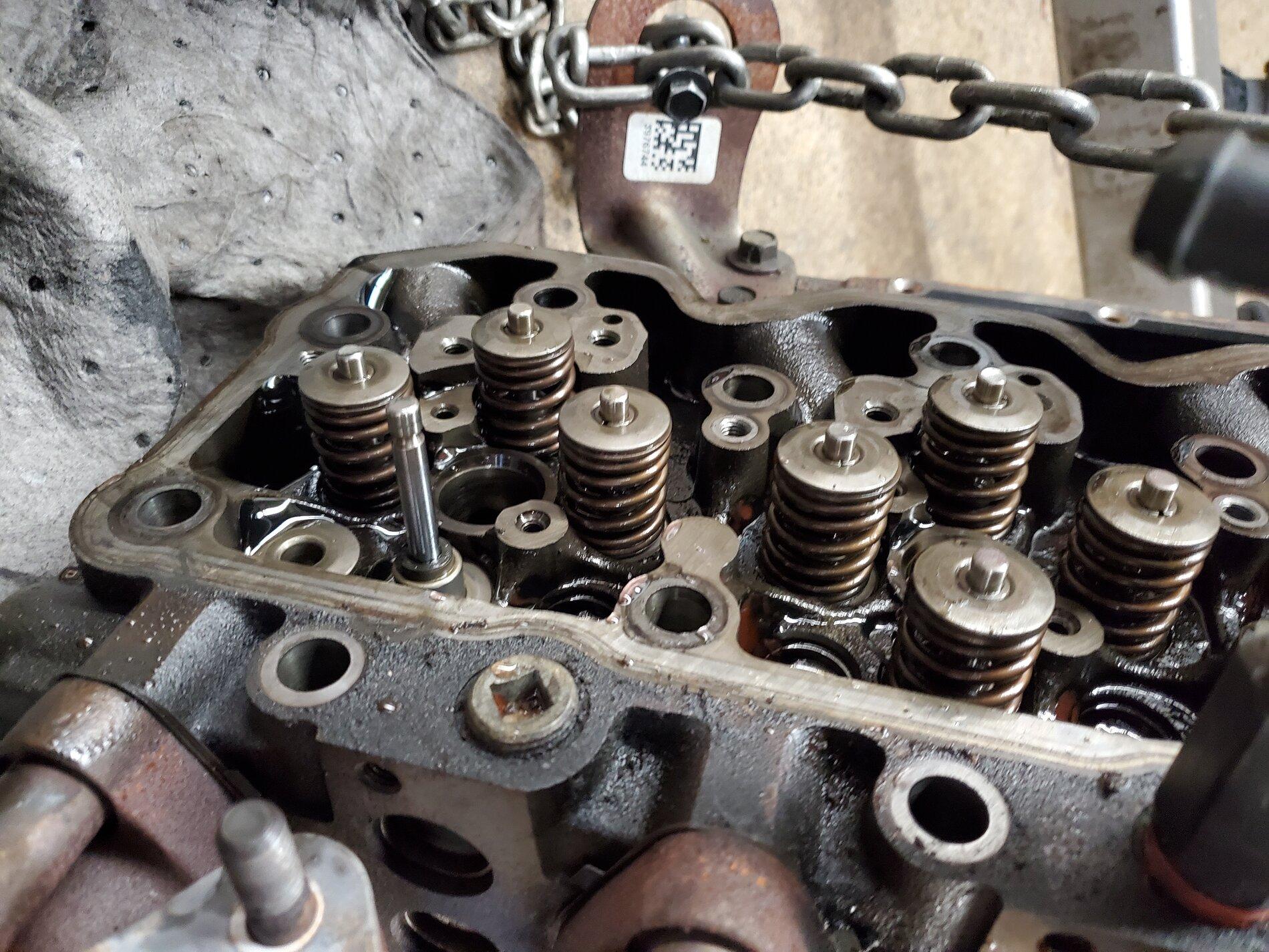

the broken spring and valve would be interesting pictures. Did the spring break or did the keeper fail and drop the valve? The head off my 2003 looked way worse. Esp cause someone cleaned it up and slammed it back on.
All pushrods need to be checked for being bent. But a longblock should have a different set already installed.
I never saw the spring, not sure if the tech found the pieces or not, will check though. I think the Cummins long block includes injectors.
Yeah buddy, made a big old mess out of that cylinder!
They will most definitely not try and repair that, only a replacement of the long block will be done in that situation.

If you look at that 3rd pic of the top side of the head, you can see the valve stem is still in the hole, so the valve head broke off, as I suspected from endoscott's description, and that bouncing around in there did all the damage. I imagine the broken spring stayed in place after it broke, but allowed the valve to drop enough that the piston hit it and broke the head off.
As to the injectors, not sure if they are supplied with the long block or not, definitely would be better if they were.
And, the long block will most definitely have the pushrods already installed.
