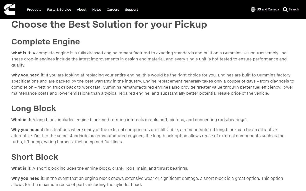

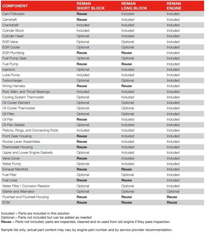

Well from that list it seems like all the important bits are included... Turbo would be the only psc I would confirm didnt get metal in it.. If it did, I would also ask about the SCR/DPF if metal bits ended up that far down.

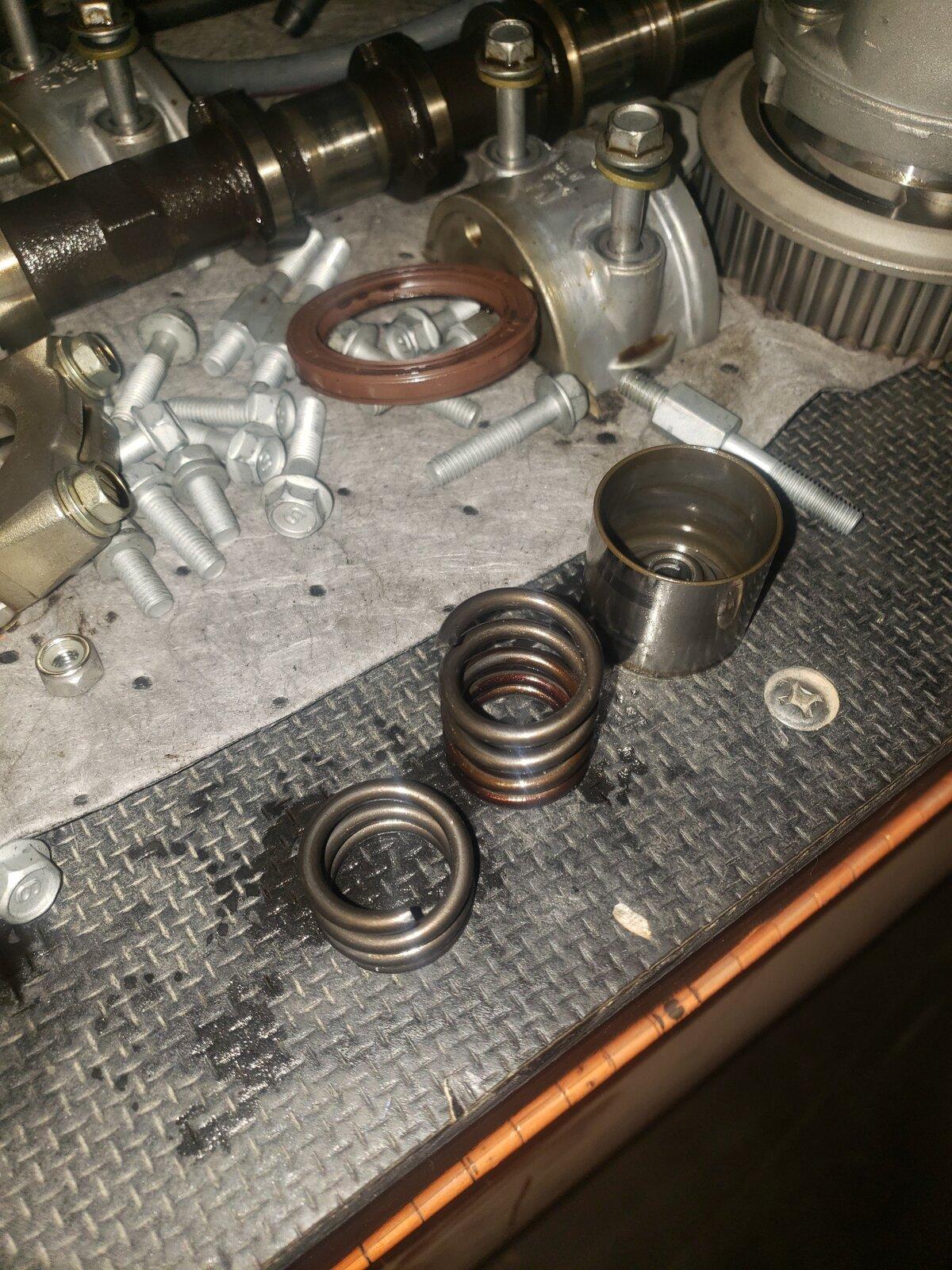

This is a broken valve spring from a Yamaha F300 outboard. A touch over 1k hours of run time and propped correctly. Part just broke. Yamaha wasn't interested in the least.
Surprised Yamaha wouldn't look at that. If nothing else out of curiosity! Did it ruin the whole motor or were you able to rebuild it? I had a Yamaha 115 on my 1989 Wooldridge Alaskan jetsled with probably 1500 hours. Still ran fine with perfect compression when I sold it a couple years ago (no more fish in the Snoqualmie River!). Had a couple of those old 500 CC Yamaha Waverunners, also freakin' bulletproof. I mean teenage kids thrash things and they never quit on us. Kind of wish I still had those things.
Dropped the valve and things got ANGRY! Customer was 1 month out of his commercial 1 year warranty and they told him to pound sand. He had to purchase a new powerhead to the tune of 14k.
